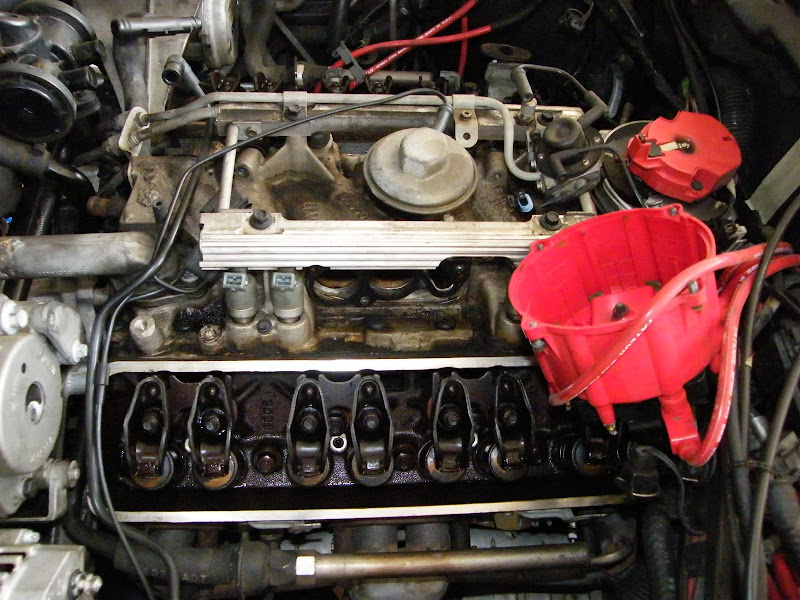

Well no that I have everything opened up I have a question. My stock 1989 L98 has some type of guide plates installed. I'm trying to figure out if I need self-aligning or not. Everything I read say I do for this year, but I thought that guide plates went with non self-aligning rockers?
I'll try to post a photo later.

Here a photo, you can see the plates, but maybe these aren't "true" guide plates?

Those are not guide plates.
Those are assembly aids for GM only.
You need narrow self aligning rockers.
Grind off the tabs in the stock valve covers.

OK, I figured those weren't true guide plates but I wanted to check.
