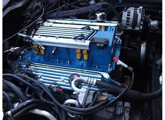

Pics I took of the LT1 manifold I bought from a Forum member to replace my 91 L98 intake. I painted it Chevy engine blue as the exterior of the car was blue.
I was misdiagnosed with a life-ending disease as I was nearing the end of this project. I returned it to stock and sold the LT1 intake and sold the car along with my truck and most of my tools. I was clearing the decks so my family would not be stuck with a lot of stuff to sell.
Fortunately for me, I am still alive and kicking and have moved from Michigan to somewhere warm.
I learned how to do this modification from a lot of Google searches. There are a lot of Camaro L98 owners who have done this and posted scads of information on their forums.
