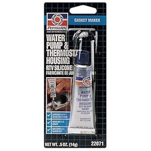

Ok, I am going to try dremmeling and is this ok for the bolts? I am going to use it along with the gasket too:

Ok, I dremmeled the edge and some of the rough parts... I think thats good enough, it came out pretty good, I will post pics later... Now, will that gasket stuff be good for the bolts or do I need the Teflon stuff?

If it does not say its for threads I wouldn't use it.I used what I used because it looked like what GM used from the factory.
I would think any pipe thread sealant would work.I just used the permatex on mine because it was at the auto parts store,right next to the HIGH TACK stuff I used for the gaskets.I have no leaks,some people have leaks and have to pull it apart a second time.
