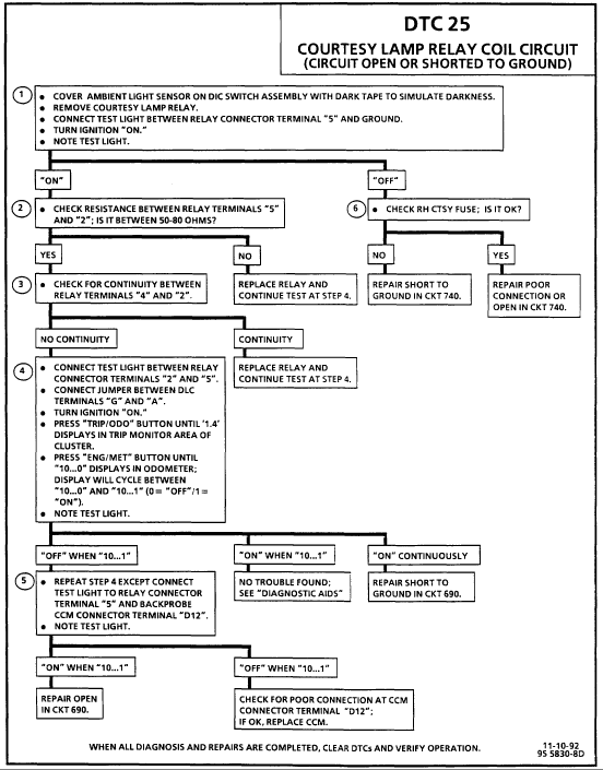

Steve A - G is CCM A -B is ECM
Try this
CIRCUIT DESCRIPTION
The courtesy lamp relay coil circuit is completed by the CCM when it receives a courtesy lamps "ON" request from any of a number of different inputs door locks, door ajar switches); the CCM grounds CKT 690, energizing the relay coil.
DTC 25 will set when CKT 690 is NOT at battery voltage for over 600 milliseconds while the CCM is NOT attempting to actuate the courtesy lamp relay not asking for courtesy lamps "ON").
I have some more info if you need it.
Bob

That's great Bob, thank you for finding that. My first question is, where do I find the "courtesy lamp relay" so I can do the first test?
Steve

OK, I know I'm not very smart, but I assumed that those relays shown would be on the engine side of the firewall? I can't find anything in my engine compartment that looks like the diagram.
Where should I be looking?
Steve
