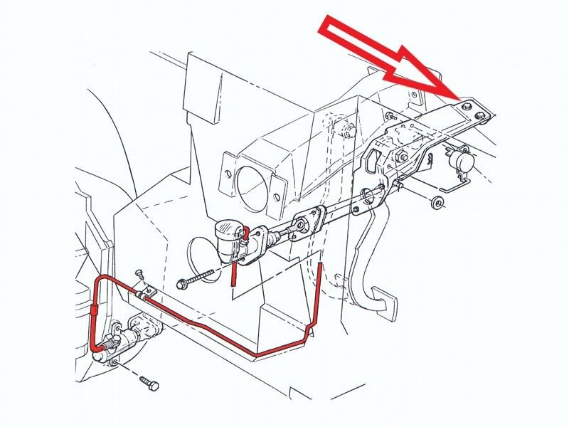

Check out this nice diagram of the whole system...hope this helps...good luck pal...

Thank you
This is exactly what I was looking for....
So it appears I have to remove the dash and the supporting frame to have access.
These cars are never easy to work on.......

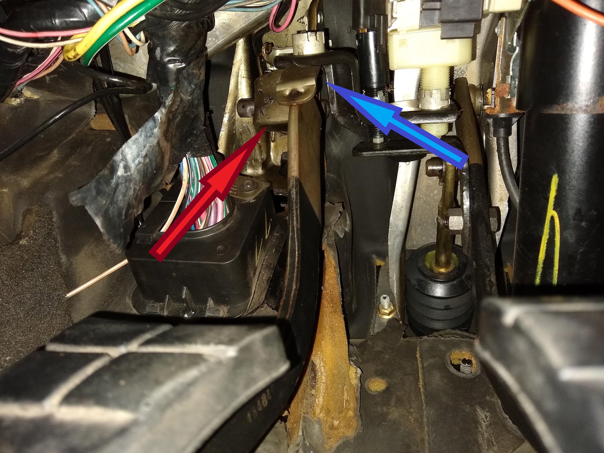

I think my pedal is bent where the red arrow is pointing. The blue arrow is pointing to some position switch contact, and I think that's supposed to be flush with that black bracket. I have one of the very few corvettes that didn't come with cruise control (working on remedying that) so I think that bracket is for the cancellation switch.
Right now, the pedal hits the firewall and there is still plenty of travel in the master cylinder. The 'contact point' (blue arrow) is what lead me to believe the pedal is bent.
I pulled the spacer out from behind the master cylinder, and it puts the rod too far into the firewall. It's partially actuated when I try to hook it up to the pedal.
Other peoples clutch pedal pictures show that bracket contact sitting flush, so I'm pretty sure mine is bent.

I just took these of my '87 4+3 with cruise control. I thought the missing switch in your photo is the clutch safety switch to prevent starting without pressing the clutch. I need to go grab my electrical book to confirm. The two switches on my brake pedal should be brake lights and cruise control cancel. Years ago a spacer between the clutch rod and my clutch pedal failed and I had to install a new one. I laughed when I just took this photo and saw the ziptie. Hopefully the clip is also still there and not lost. I'll need to take a closer look.

It almost looks like your clutch safety switch is over on your brake pedal. Do you need to press the brakes to start your car?

Thanks for the picture scorp!! That totally confirmed my suspicion that my pedal is bent.
As far as starting the car, I've always just done it in neutral with my clutch pedal on the floor. I might have to do a little experimenting tonight to see if indeed my safety switch is on the wrong pedal.

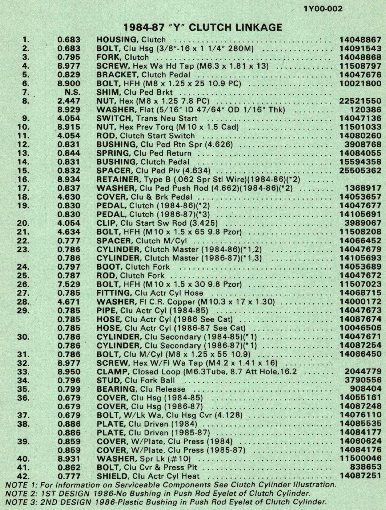

I've never removed the pedal from mine. I've attached a couple other images for 84-87 which should be similar. I hope they're helpful.
84 to 87 Clutch Linkage Illustration
84 to 87 Clutch Linkage Parts

AWESOME - that exploded view is perfect!! Is that from the FSM?
I was able to get the assembly out and the pedal is DEFINITELY bent!
I'm working with a Facebook group member that has a straight one that can come my way.
What an amazing pain in the butt to get that thing out. Instead of bending it back, I'm willing to pay for a replacement that I know is straight. I only want to reinstall this thing ONCE!!

It's from a Parts & Illustrations catalog I scanned to PDFs. Mine is for 84-87. There are a bunch of eBay right now; the one linked below is 84-88. I've thought about buying another one that covers later years as they usually have some updates for earlier years as they find/update part improvements.
