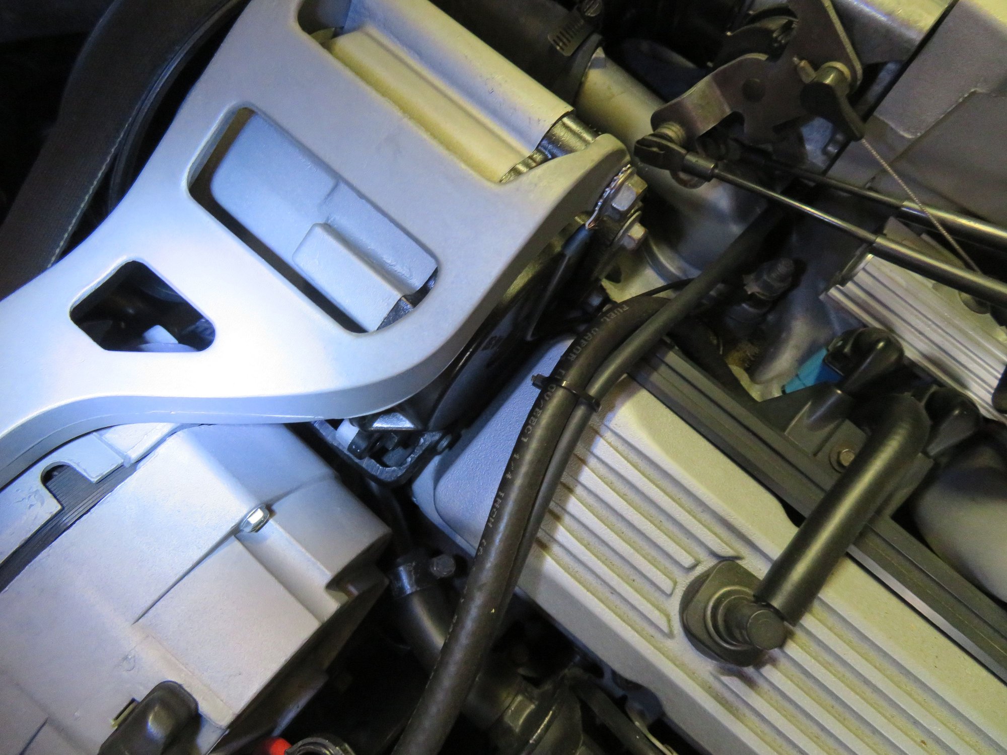

The FSM says to remove the smog pump. You don't really have to do that. There is one bolt that sticks out and keeps the valve cover from coming off. I used to just pull out that one bolt. I cut the bolt off and now I don't have a problem:
good point cliff. I assume were talking about sharkface's post on removing the VC from an 85. , on the 86-up L98, however, the 1985 iron head configuration is different. while there are some 85 owners who have managed to get the LH valve cover off without removing the smog pump, I can tell you it is a major PITA. far easier to take an extra 10-15 minutes, remove the smog, and do it by the book.

My 86 looks like the first pic in Cliffs post...
