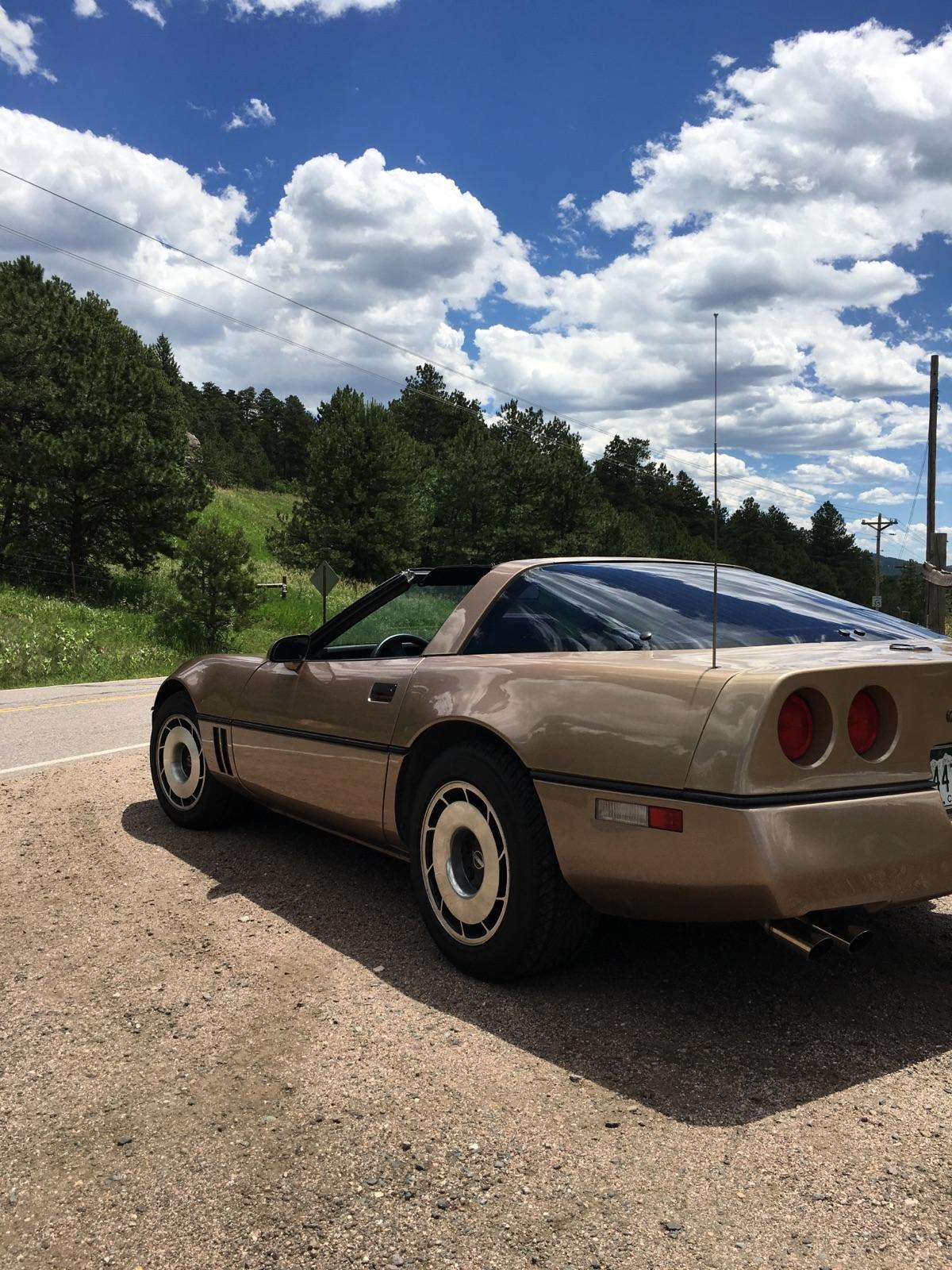

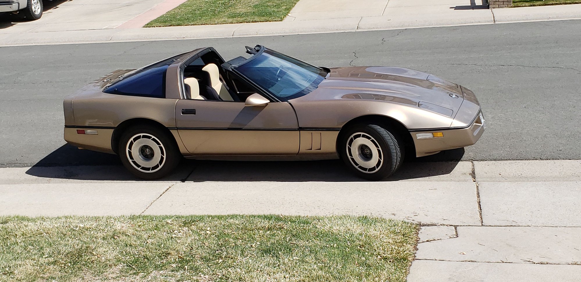

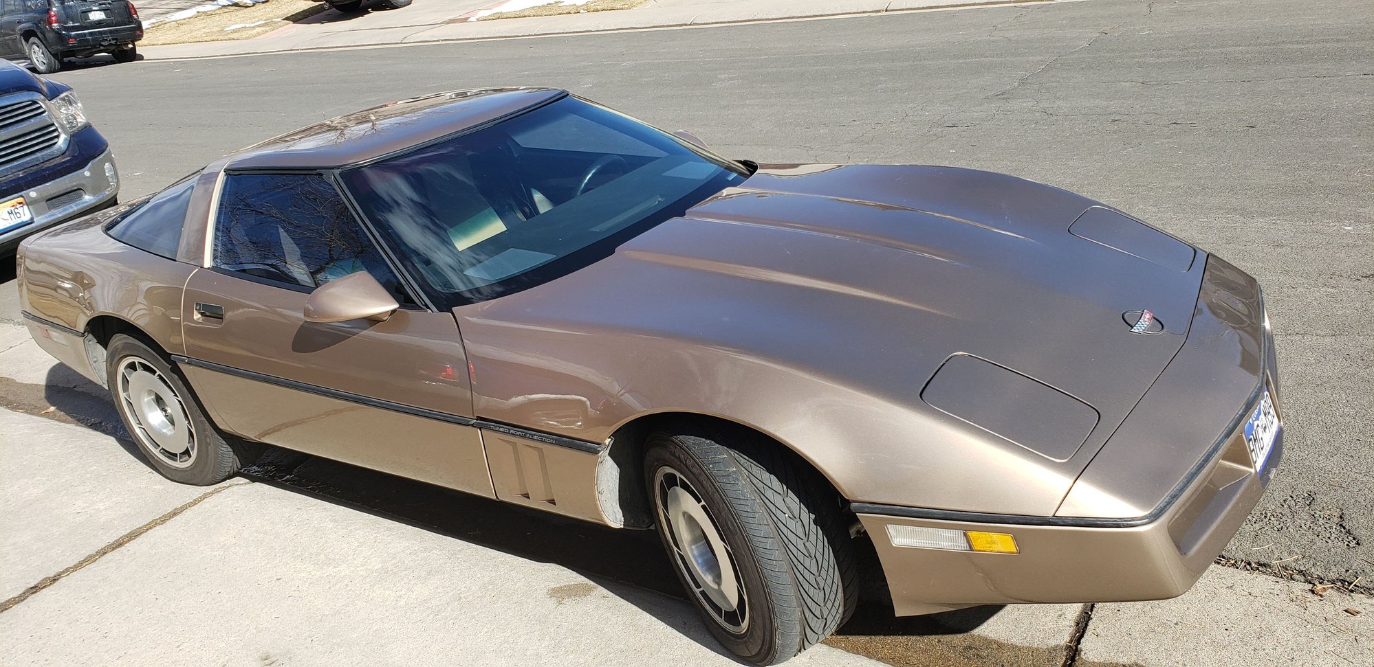

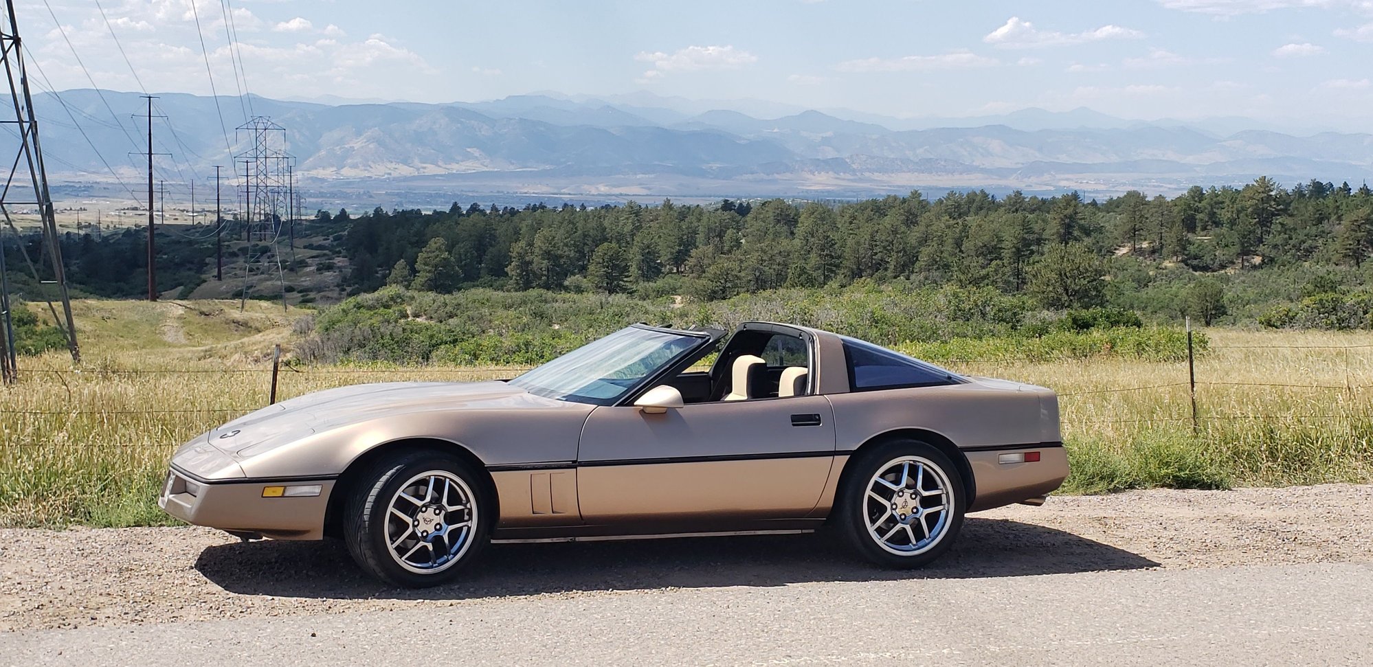

I've had 245 50 16 tires for about 5 years now since I couldn't find 255's at the time. I thought they looked fine but you be the judge.
I just changed to C5 Z06 wheels this summer.
