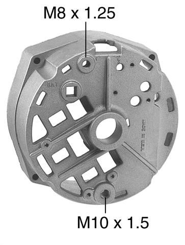

Original production '84MY generators were 17S! - early cars or maybe all production was 97AMP and later the only service generator was a 108AMP.
Here's a 17SI slip-ring end http://store.alternatorparts.com/Pro...384_SUB_WC.JPG
Here's a 17SI drive frame:
http://store.alternatorparts.com/partno21106.aspx
The 12SI had an 8mm mounting hole on one end and 10mm the other. There was also I believe two different dimensions from center on the 10mm hole.
Now what I thought the ideal generator upgrade was to the CS130/CS144 or is there an "authenticity" requirement? A 17SI @ 140AMP might be hard to find, don't know. 120AMP were used on loaded Cadillacs and I don't recall anything else.

Ok, I thought it was the 17S but wasn't sure. So if the listing says 17s or Large Style it should be the same then
Old Aug 27, 2012 | 03:43 PM
WVZR-1's Avatar
WVZR-1
Joined: Sep 2003
Posts: 25,366
Likes: 2,732
An original '84MY 97AMP (1105513) and the 108AMP (10479865) - anyone you buy from should be able to confirm those are 17SI with 2 10mm mounting holes. Check the mounting holes on yours from the images I gave you. You should be fine.
