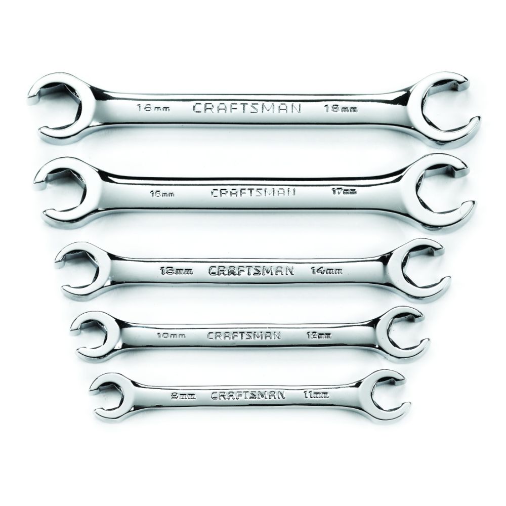

That's a very "clever" pointer you've got there!! I believe with the proper flare nut wrench you could be OK.
You just need the correct size and I don't recall it. It would be good to have a set of these. They're very handy.
