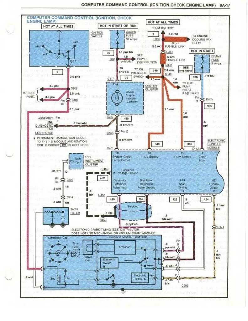

Not sure why it would show while charging and then disappear. Here's the schematic..
Hope this helps..

Before I ran a 12v wire, I would check pin E of the ALDL for ground, plus the gauges fuse for corrosion. If you don't have the ground on E then putting 12v on the cluster wont help..

After further checking it appears that the pin "E" designation on drawing 8A-17 is incorrect, from both the ALDL pin out and another on page 6E2-8.
Both show pin "D" as going to the check engine light, this is where you should get the ground for the CEL from the ECM..

Thank you but D was a blank plug om mine. I am going to take it to the shop. .
