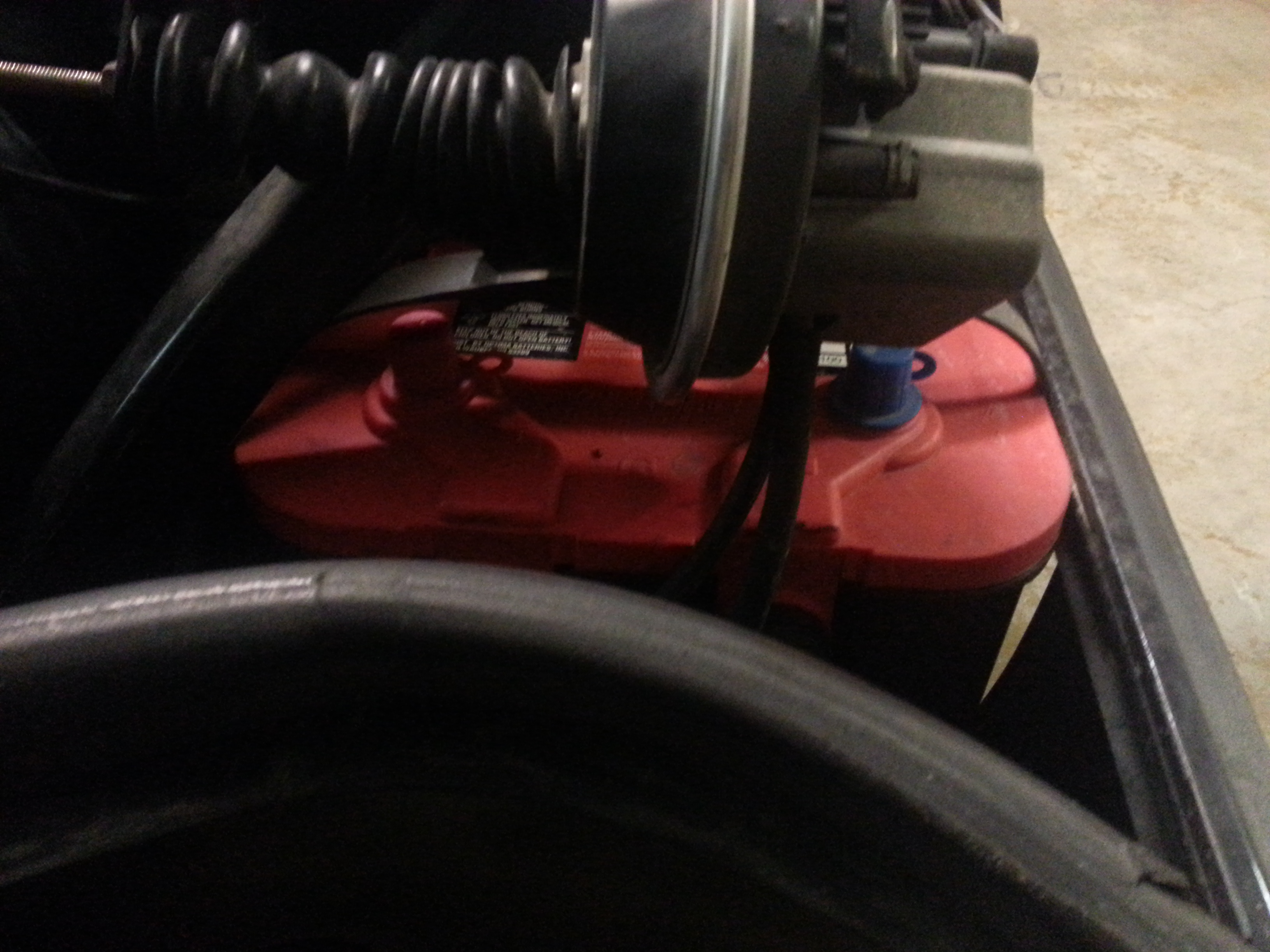

I ran a couple of Redtop Optimas for years in my C4. Just hacksaw the top terminals. They can't short against the brace if they can't contact it. Gotta think outside the box.

I've got a red top in my '85 and I have no contact problem at all. The negative post is close to the cruise control but the positive post has plenty of clearance. If it did not I would just do what 383vett said, get out the hacksaw.

The optima battery fits ok.. The hood support brace needs clearancing.. and the outer battery tray needs the lip cut flush..
I took my brace out.. and neatly crushed in the edge for clearance. That brace is very strong especially the edge's

mine fit with no modifications

I have a redtop and had no clearance issues. Took a little twisting around to get it in place, but nothing major.

Nope, mine has top posts, can't really use them though.
