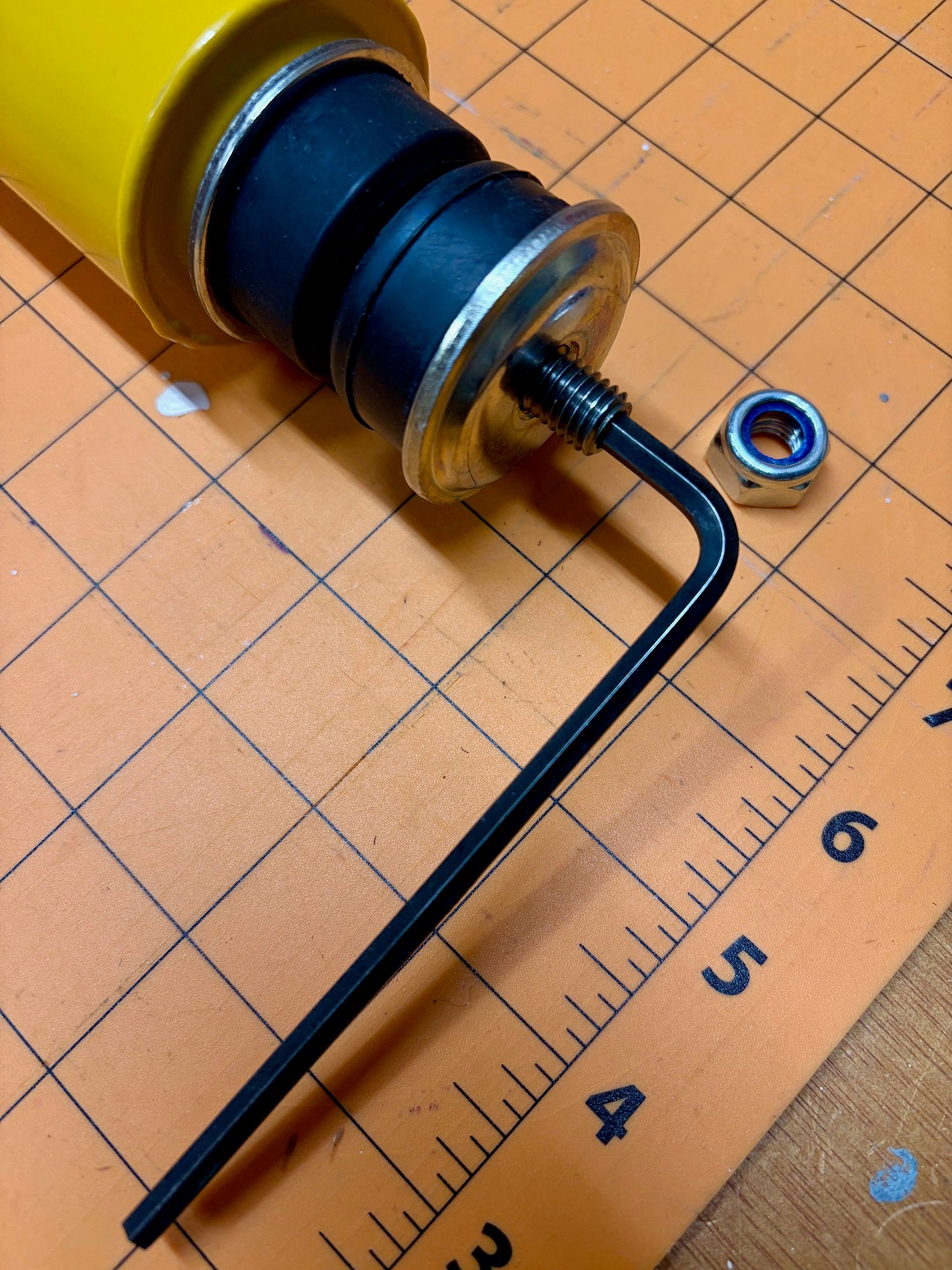

Thanks, but what is the correct size wrench for the nub on the top of the front shock. To be clear this is the little nub on the very top it is used to prevent the shock piston rod from turning as you turn the top shock nut that compresses the bushing and hold it in place. Was afraid to use vice grips since that may make it worse?!

Originally Posted by FASTAZU
I always used the correct size wrench on the top (don't care for the adjustable wrench), but if it strips as many do I would try a pair of vice grips on it. As a last resort you can cut it but its some hard steel.
Good luck
There's a Allen head hole on top of shock you have to place Allen in center top and use a wrench to turn the bolt shock wont spin

Originally Posted by CFeria
Thanks for the advise, today I decided to try to remove the front shocks just to be sure I am able to when the new ones arrive. Right side ok, no prob. left side trouble getting the top nut to break free. also kinda stripped the top of the shock where you hold with adjustable wrench while you turn the top shock nut. So I was wondering, when the new shocks arrive, can I just use a cut the top shock stud where the nut is located? I would try to cut below the nut but if that's not possible I guess I could just saw thru the nut too?! What is the process of removing this nut on the front shocks if it just wont move?
Thanks for reading and thanks for any advise!
