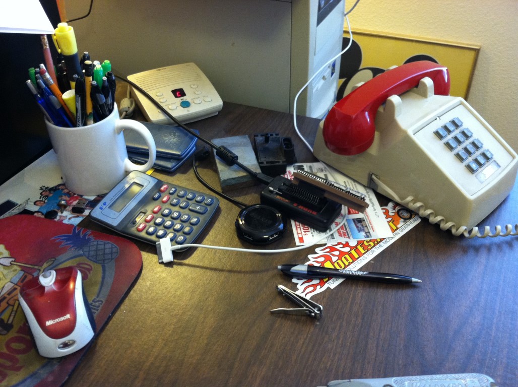

Originally Posted by drive it
You can plug the adapter into your burner and the other side prongs plugs into the bottom of your "chip" without having to unsolder the prom. Before I started using the ebl I did unsolder it and solder in a reflashable prom so I didn't have to uv light erase every time.
looks like this:

I've done this a few times. Look at all the Moates pens in the cup on my desk. I buy chips 20 at a time. I enjoy helping you, so you're welcome.
