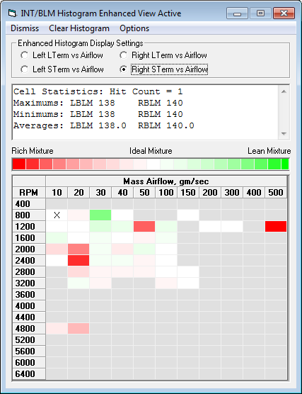

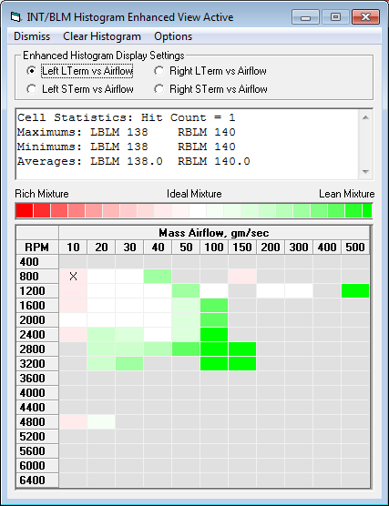

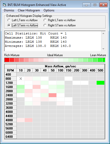

Default Posting pictures and video of my datarun
bumping this thread up with some pictures of my datarun, screen capture to follow in a few minutes. I have pictures of my histogram. I know there's something wrong here I just don't know where to look.

Ok from what I can tell you are getting intermittent "Data Err" which means you are possibly losing communication while datalogging. Please make sure that you have "Disabled CCM Handshake" before datalogging. This is found when you start to record under Options, Advanced then choose "Disable CCM Handshake". Then try capturing a new Datalog and resend me the new file.
