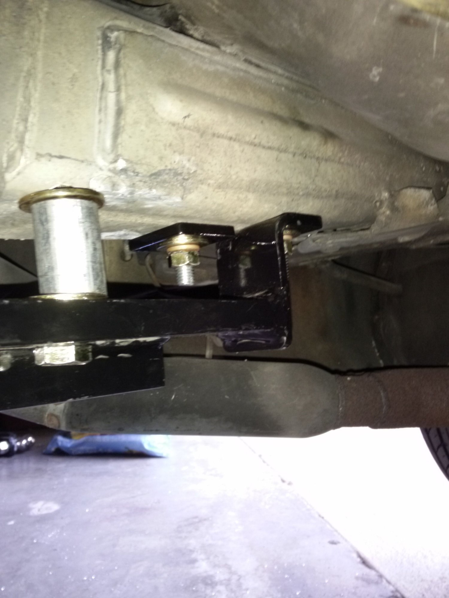

Thanks again ! here's a couple pics showing the small bracket i placed it behind the front hitch mount to clear the fuel tank strap bracket.

Looks great!

How did you get the u-bolt in the frame?
thanks
