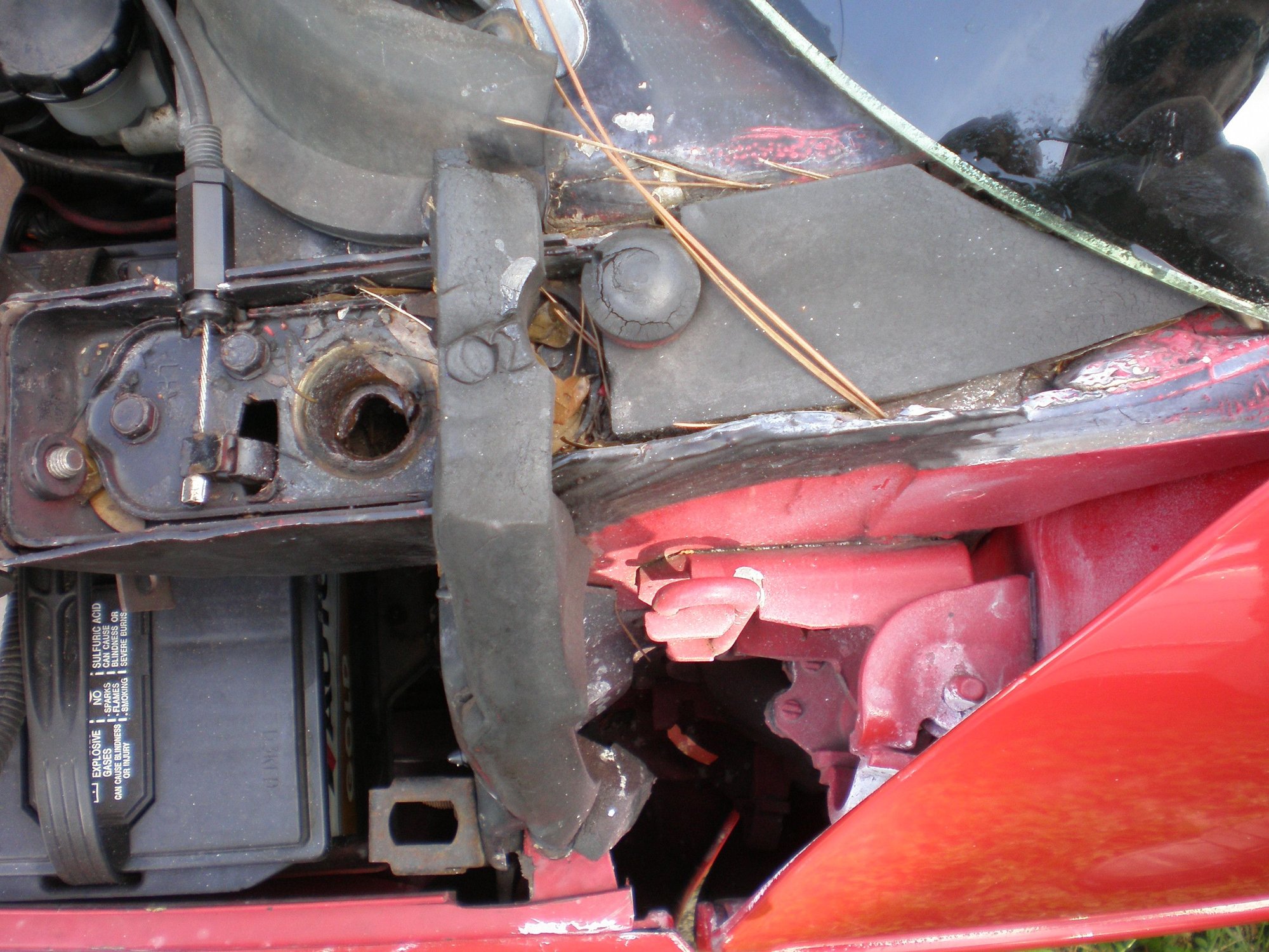

I did this job today!!!
Much to my surprise I got it on the first try...
I made the tool out of a 3/16 steel rod..
Most of the videos show how to with the hood open...
I used the short hook end to pull out the foam padding and removed the padding close to the windshield.. You can then see the spring.. then the cable latch is just behind it.. I cant imagine trying to do this blind..
Find one close and have them open the hood and take some pictures.. and measure the lengths..
If I can help further please let me know..
Put " hood release broken " in the handy dandy search tool up top..lots of info there too..
Craig
You can see the two foam pads here..
Not my car pictured...hahaha a ragged 87 at a local buy here pay here lot...
Good luck!!!
