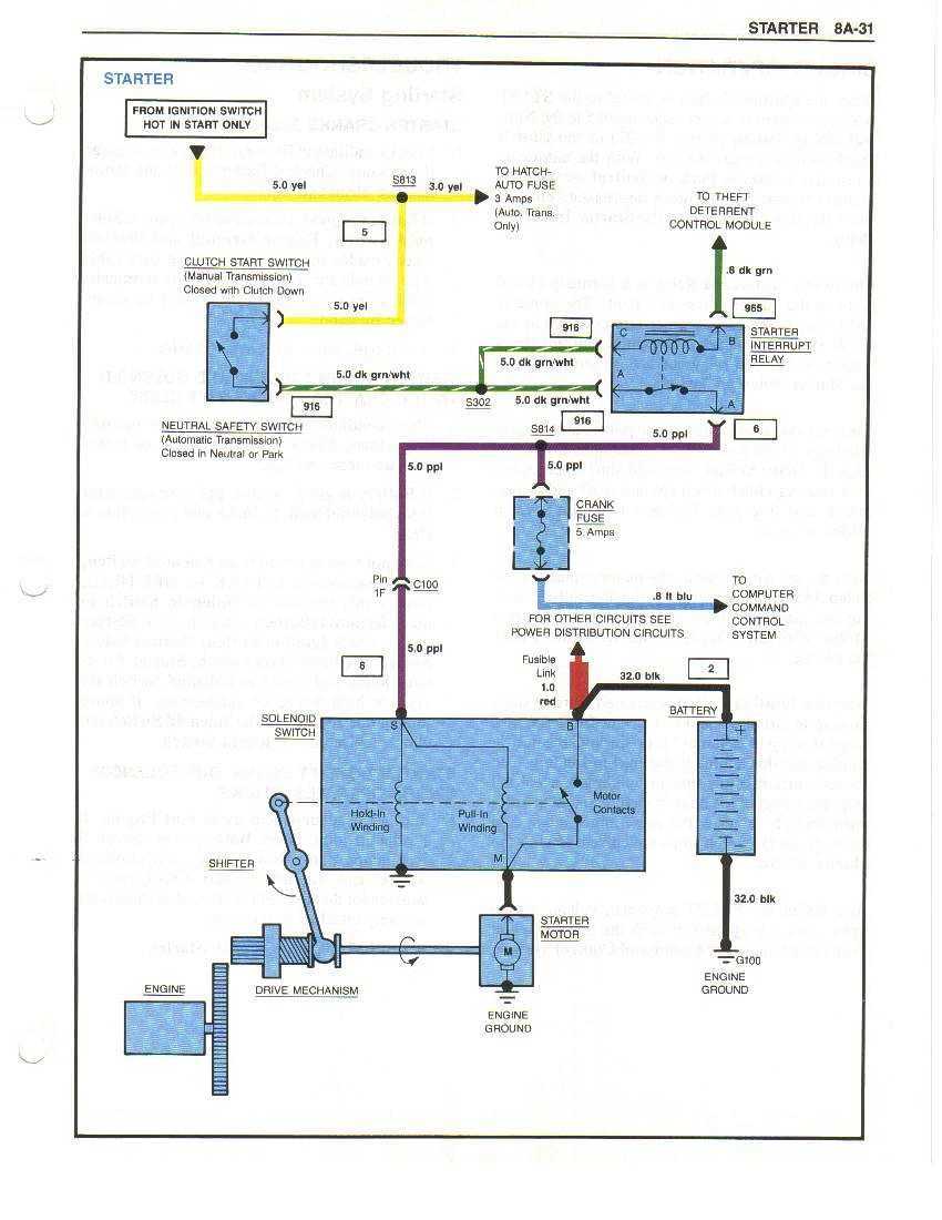

Yes. First we need to identify the problem. Since you have to chip in your key, you don't have VATS.
Since your problem comes and goes, I would jack the car, attach a wire to the small/ignition switch wire on the starts solenoid, and run it to a safe (won't melt or short), easily accessible place. Then, carry a DVOM or a test light; when the symptom occurs, test for power at that wire. If you have power there, you know the entire ignition circuit, switch, P/N safety switch etc is all functioning. The problem is the starter motor, solenoid, or possibly large wire to the starter motor.
If no power there, then work your way backward; start at the PN/safety switch as its then back to the ignition switch.

Tom, here's the schematic from the 84 electrical supplement.. If you check for power at the crank fuse, it will tell you if you need to get under the car to the starter or not..
