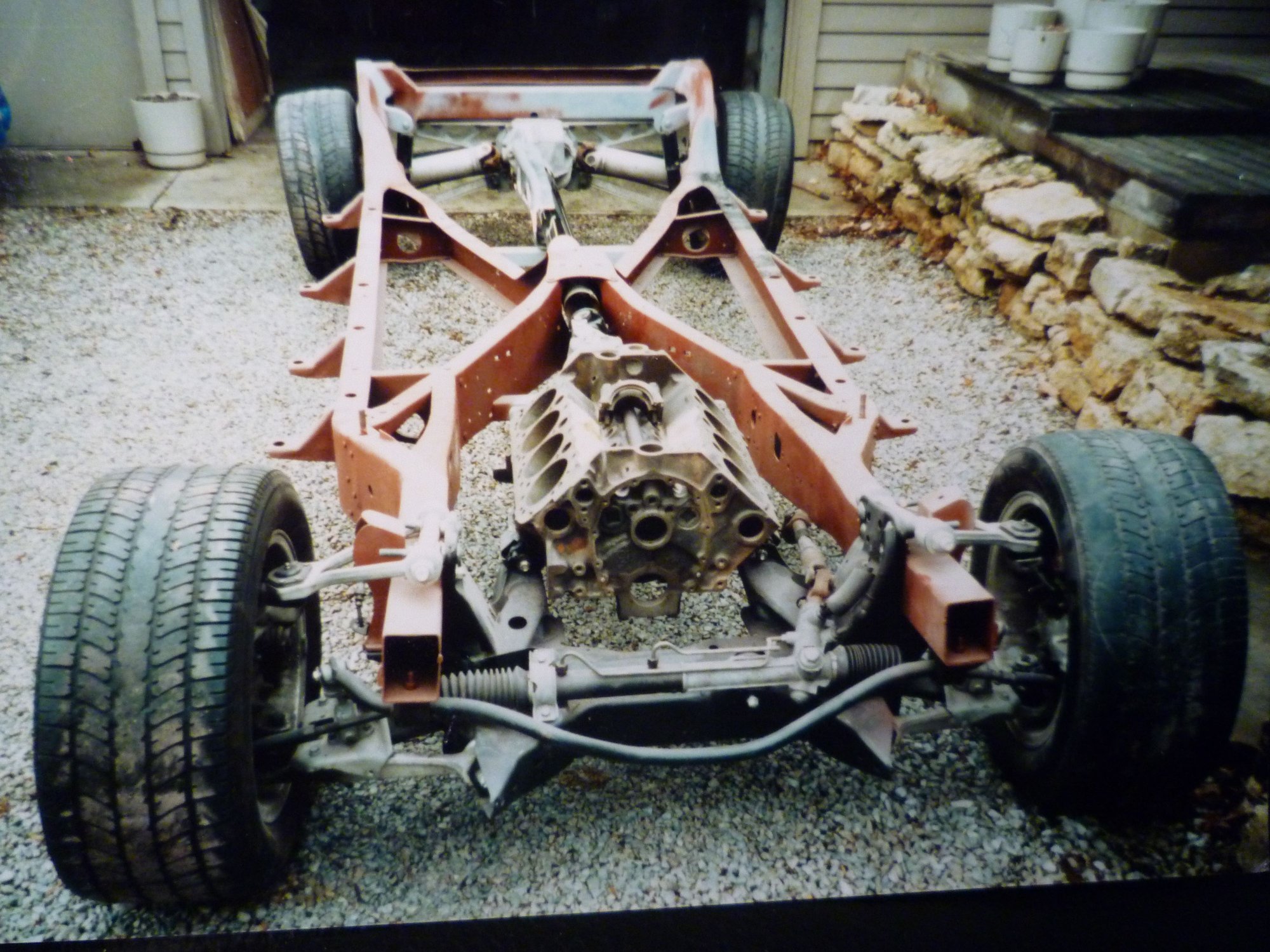

Here is the rolling chassis I built for my 1941 Buick. Wheel base is 142"
Car weighs 4100 lbs. Front weighs 1950 lbs. I installed a LOWERING wedge years ago, and am now attempting to soften the ride.
I'm NOT an engineer, but not a dummy either, I do all my own work, and enjoy such.
The car rides very harsh, cracks in pavement, small chuck holes JAR the front. I am wondering if the extra weight on the front has the composition spring compressed to the STIFF part of such. The shocks are very firm, as a test I just removed the front shocks, and it improved the ride a ton, and with very little FLOATING/POGO movement. I wonder if the spring being at the STIFF portion of its movement explains why it isn't FLOATING with no shocks.
At a show a Vette person said the WEDGE could be affecting the ride too. I have/am considering converting to COIL-OVER units, but now that I have improved the ride WITHOUT shocks, maybe I should install good quality ADJUSTABLE shocks and see it such doesn't improve the ride quality. For your info, it is NOT bottoming out.
I'm sorry picture is so large, I did reduce to small, but this is what I got.
I am going to pull the composition spring and try to determine what spring rate I have, and will post such.
Any and all comments are welcome, I can not be offended.
Dale in Indy

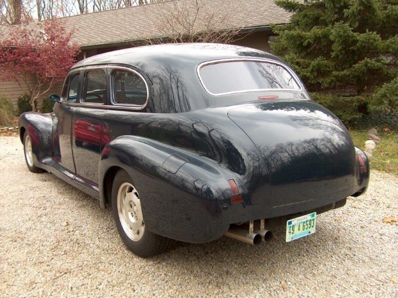

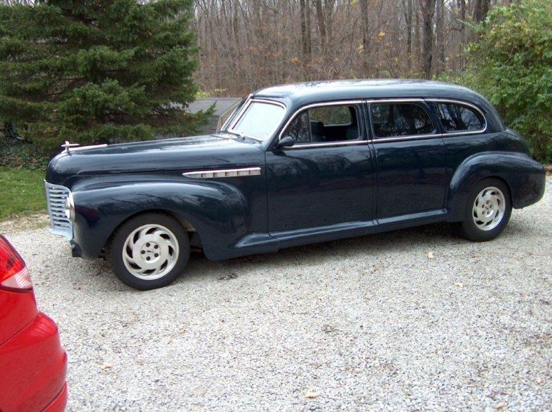

Here is my 41 Buick Limited. It does NOW have bumpers.
It is the biggest Buick made. Factory Wheel Base was 139, I had to push WB back 3 inches to get the rear control arms behind, and in the frame kick up.
You can see it runs 17" Vette rims, but NOT low-pro tires. Fronts are 28+" tall, and I carry 32 lbs. air pressure, could back off to around 28 and see what that feels like.

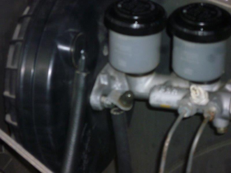

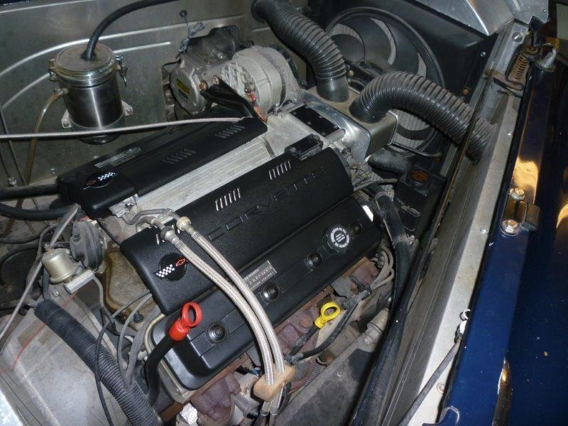

Here is the 96 LT-1 Vette crate engine, it is hooked to a Coan 700R tranny.
Trying to ID the suspension, I purchased the front clip of a Vette that had broad sided a tree, cut the car in half behind the driver. I got the complete clip without the engine or tranny.
The master cylinder came from the car, and maybe the numbers from it might ID the front suspension.
Says,,,,MADE IN AUSTRALIA, made by BCIA.
Numbers on it are,,,,,,,B258-038, and 10097670 BD.
Dale in Indy
