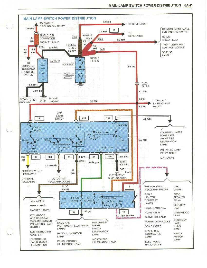

The 84 does not have the junction block, the main fusible links are on the starter solenoid..
There are two fusible links beside the battery, one to the cooling fan relay, and the other to the fuel pump relay, the oil pressure switch and the ECM..
