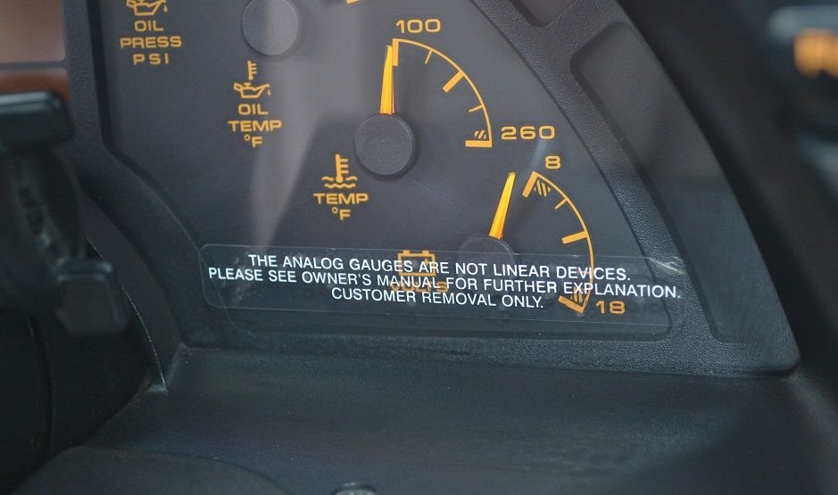

First, we need to know the temperature shown on the digital readout, not the analog gauge.
The digital temperature comes from the sensor on the waterpump.
The analog gauge gets its information from the sensor on the right side of the head.
On a 1992 the first fan comes on at 229 and the second fan comes on at 239F. I think that on a 1994 both fans come on at low speed at about 229 and then go to high speed around 239. I do not recall exactly when the change was made.
If you turn on the A/C I think both fans should run even if the engine temp is below 229.
Here is a photo of a sticker that came on all the later C4 Corvettes.

I believe the analog gauge will be near the red area when the coolant is around 230 degrees.
It sounds like the first thing you need to do is read the owners manual. If you do not have one you can get one online.
If you press the gauge button it will cycle through functions such as oil temp., generator, water temp., etc. This is the temperature you will rely on.
While the car is cold, check the level of coolant in the main reservoir and in the recovery tank. The main should be full and the recovery tank should be at the cold mark on the dipstick.
Drive the car and watch the digital temp, with the A/C OFF. It should stay around 200 while going down the road. When stopped it will climb until the fans kick on, around 229F. At that point the temps should start dropping. If the temps continue to climb, get off the road, open the hood and verify that the fans are running.

Until you post up what what the "digital" temp gauge is reading, you don't really know if your car is running hot or not.
That analog gauge needle just scares the crap out of new owners.
Look at that gauge real close, and you might notice that the needle doesn't actually reach the 260 mark. The needle stops just before reaching the shaded area.
At that point, what does the digital gauge read?
