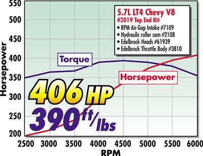

So this ad is pretty close
http://www.summitracing.com/parts/ed...gypBoCrc3w_wcB

http://static.summitracing.com/globa...e/EDL-7109.jpg

Posts: 241
From: Lancaster California
Originally Posted by cudamax
yea I think its safe to say if I just bolted the kit on as it is and no extras it would be a solid estimate
what is the loss on these drivelines?
I saw on another forum a guy said he had his 96 a4 do 84% at the wheels based off a stock engine
its gotta be more than a 15% loss. that's really hard for me to believe. id be expecting something more in the 20-22% range
