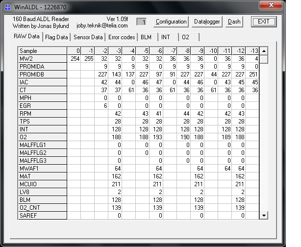

No mods to ECM. But, just fyi... This problem appeared suddenly. After rebuild, car ran awesome with no problems for about 6 months. One night problem started out of the blue. Originally it was a bad surging problem with it hard to hold it at a light. After cleaning throttle body and resetting idle that disappeared and it was running good again for a couple days. Then this dying when warm going into drive issue started. I just got done completely redoing the throttle body tonight a second time. Cleaned it up with throttle body cleaner, this time new gaskets all around. Checked IAC. Clean as a whistle. Reset TPS to .54 and test drove it. Still has same issue.
I don't have anything to read command idle from ecm. IAC count on WinALDL is 44. I will try some new plugs, check spark and I will also try resetting idle/tps again tomorrow when I got some help. Anyone know the definition of insanity?
Here are some screenshots from tonight. I went out and restarted it (WOT required) got it settled in, it was not running like it usually does. Definitely rich tonight and hunting for an idle as you an see. Dash read about 170F coolant temp. Winaldl shows 9.9F. Dunno if that is a bug in software. Fans and gauge seem to work fine.
Again take this data with a grain of salt, cause it was richer than usual after this restart.

This is exactly what I was going to say before reading your last post. Your CTS is not accurate. The engine runs richer when cold, adds more fuel during cranking when cold, higher idle when cold, retards timing when cold, etc. When your engine is hot, the CTS is telling your ECM that it's cold! That's why it's saying 9.9*F. Your problem is in the CTS. Either the sensor itself, the wiring, or the ECM. One of those is your problem.

Also your ECM uses a different sensor than your dash does.

Well alrighty then! It will be changed out tomorrow. Thanks that would make sense.
