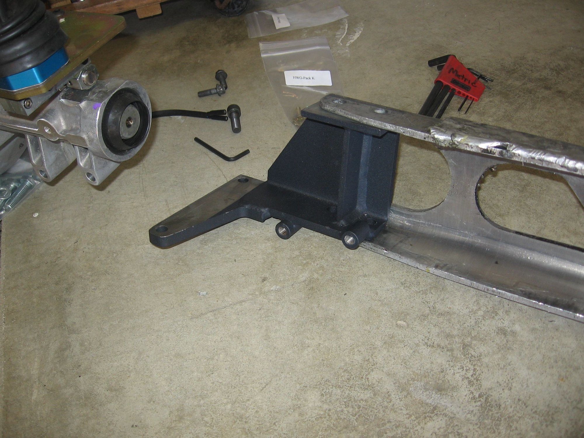

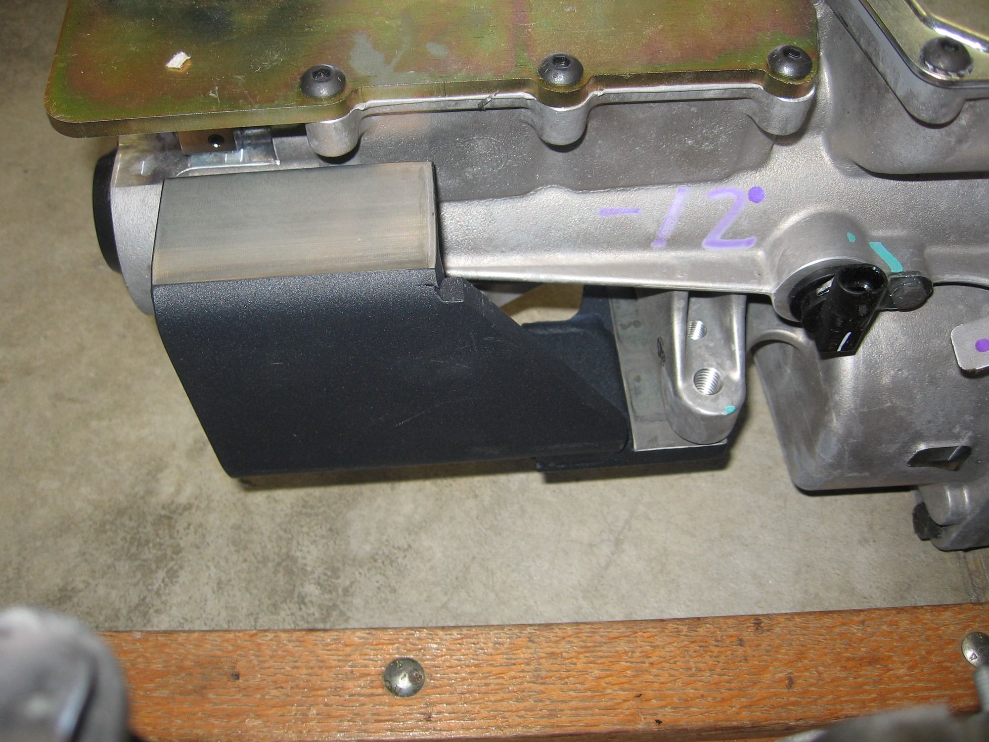

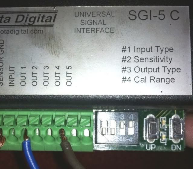

I bought an INDY shifter, cut the shifter off above the bottom hole and then drilled a new hole and it was perfect fit.

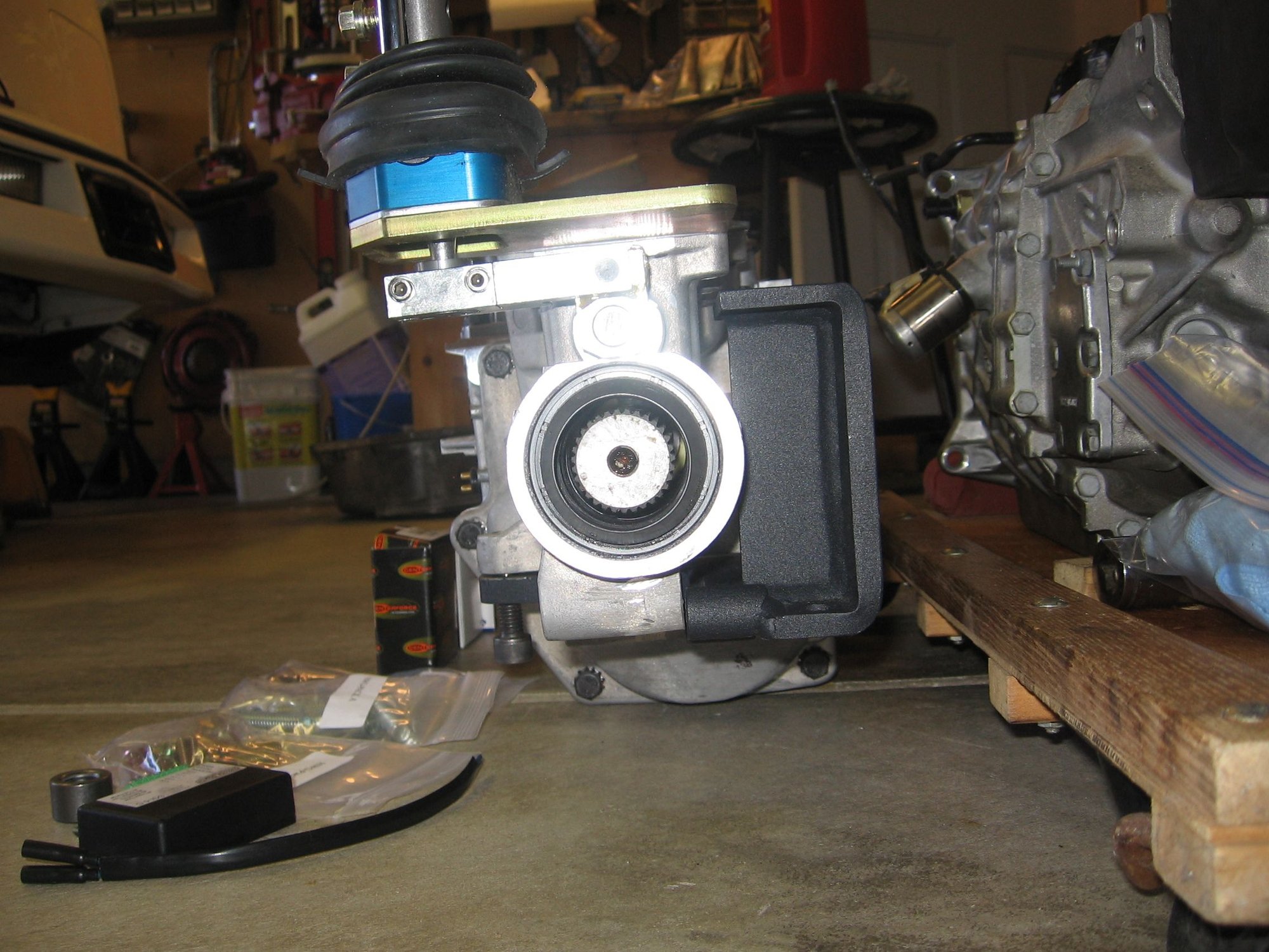

I tapped into the wire coming from the VSS on the tranny and put the Dakota Digital between the cut wires.
Blue from tranny, brown to dash

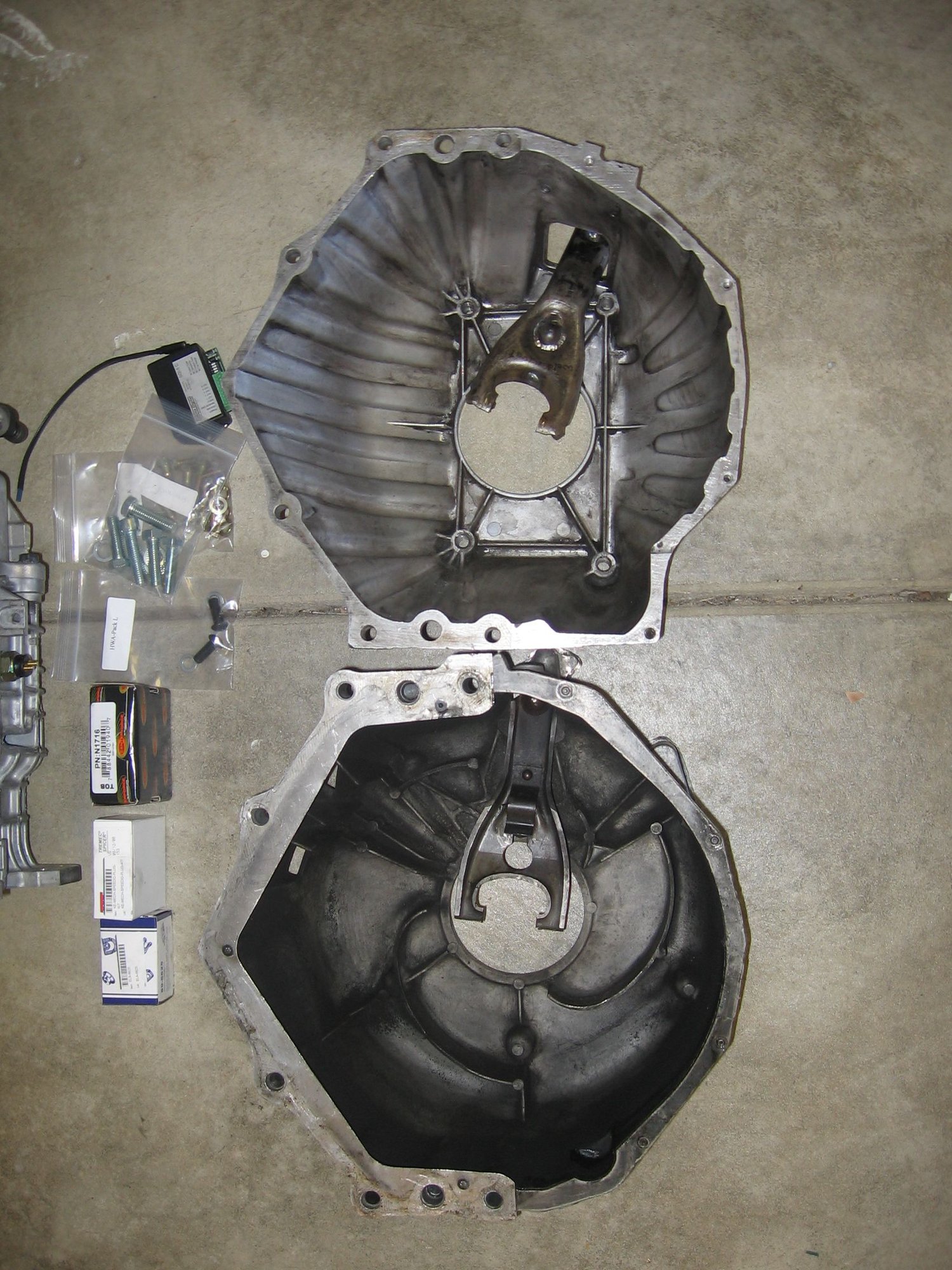

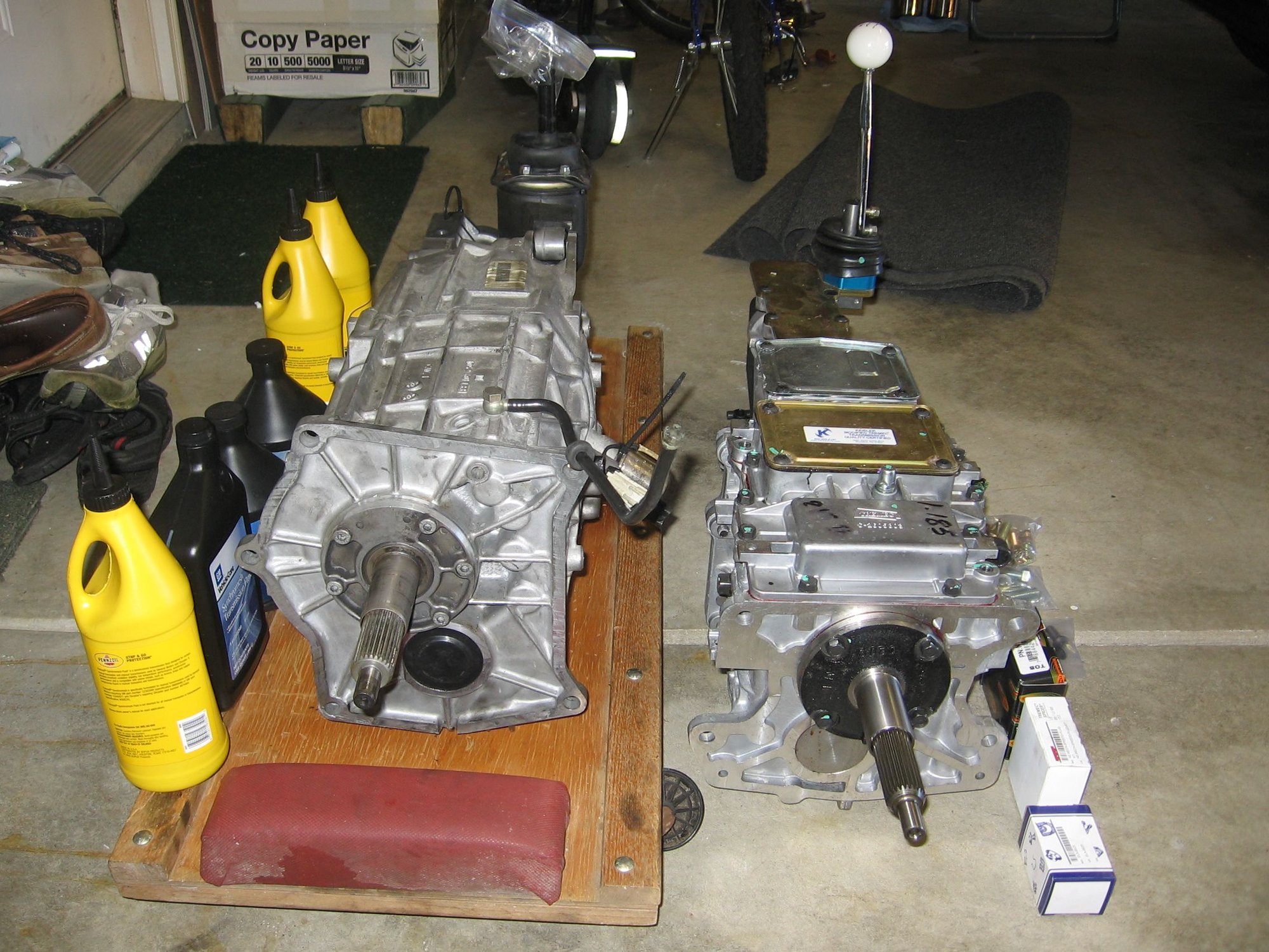

TKO next to my ZF Blue tag
