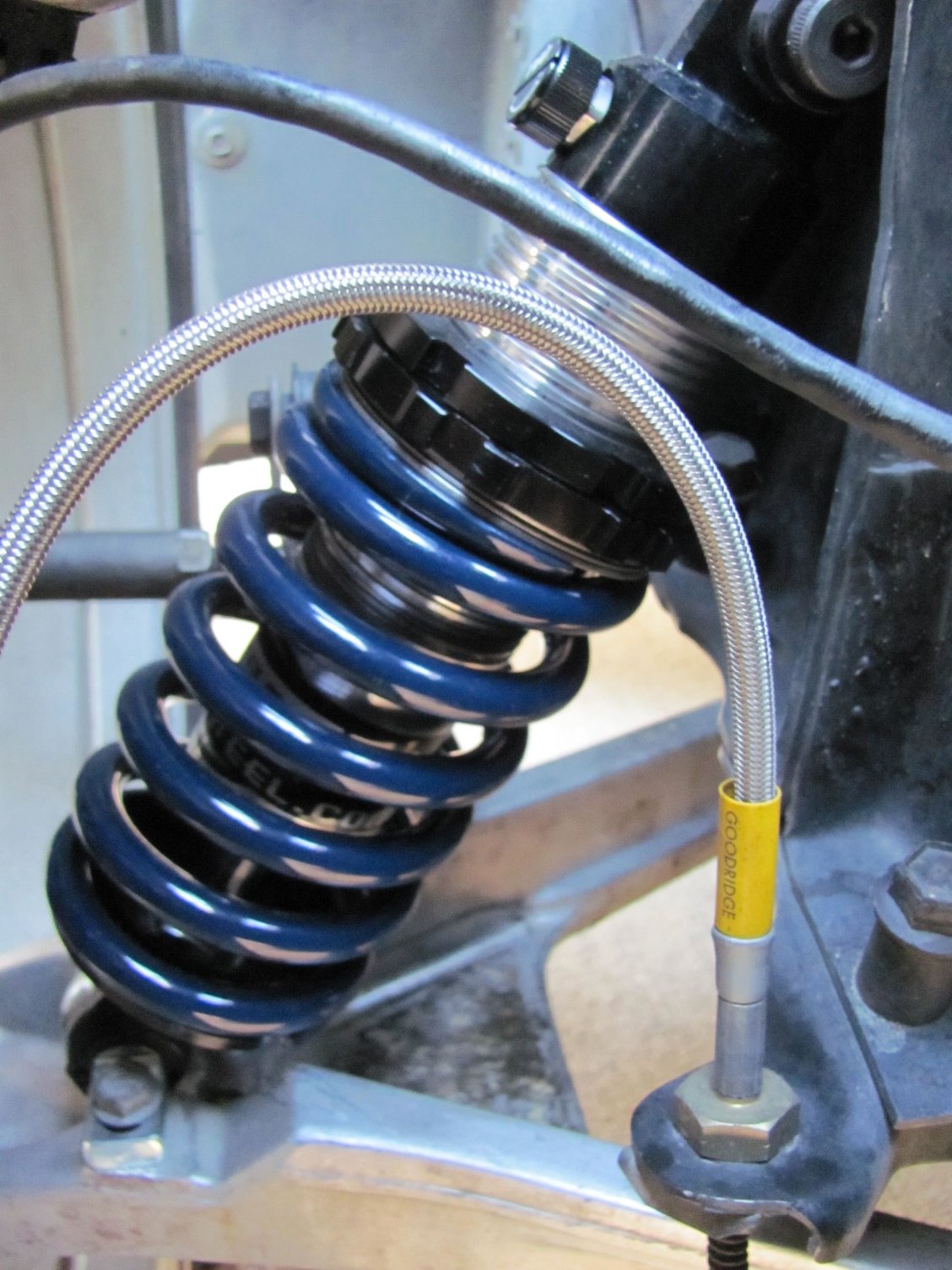

I purchased a set of the coilovers that VANSTEEL offers for my 91 and wanted to report how helpful they were with helping me get things correct. We worked with some different spring lengths until we got the height and usable coil travel worked out. Dan sent new springs until we got it right then paid for the shipping to return the ones I didn't use.
Great vendor to work with!!!
The ride is better and you can get whatever height you want.

Their kit has hyperco springs and QA! shocks single adjustable. I did front and rear. They only show one set of mounts, or at least for what I saw for a C4. All the parts in the kit were very high quality.

The ride is better, the ones I have are single adjustable so I can change the ride. Currently it is 26.5" all around to the top of the wheel well.

400# front 350# in the rear. That was their recommendation based on the fact that I told them it was for cruising. A single adjustable changes compression and rebound. With a double adjustable you can set the compression and rebound separately. For street use the single is all you need.
