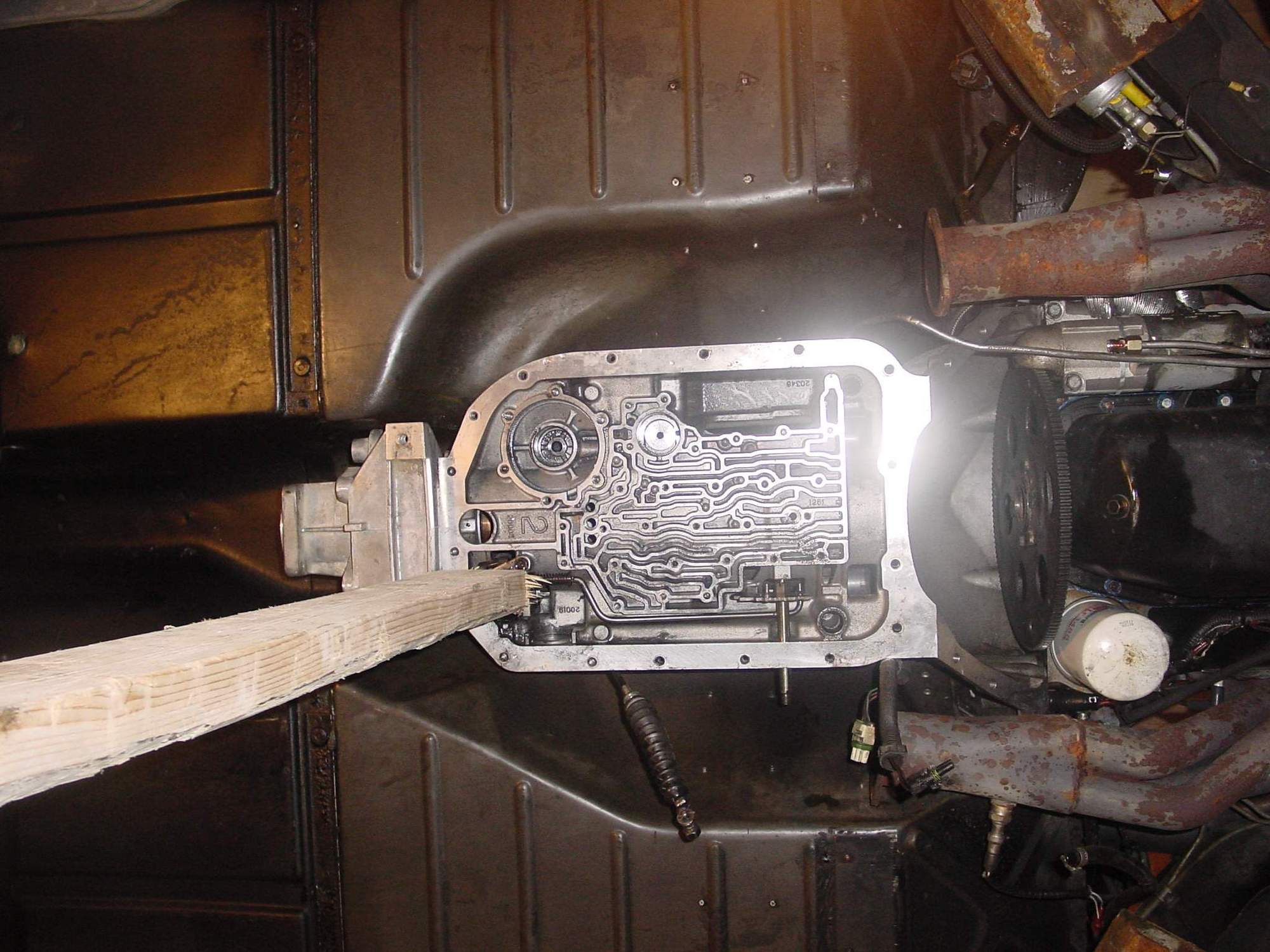

Originally Posted by bogus
The 4L80 is a beefy box... TH400 with an OD attached... but it requires a lot of cutting to the trans tunnel to make it fit a C4.
No cutting at all, here a dummy 4l80e fitted into the C4 tunnel

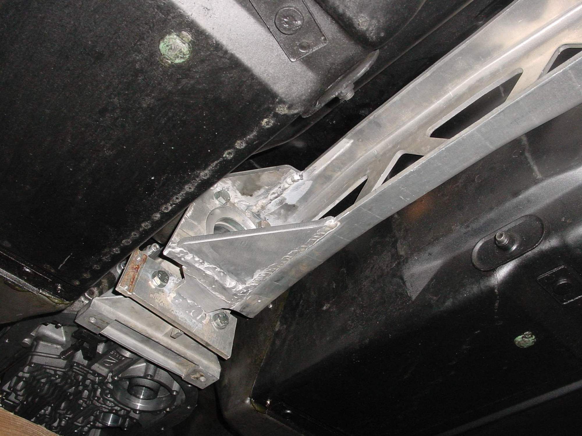

modified Cbeam tail housing flange
