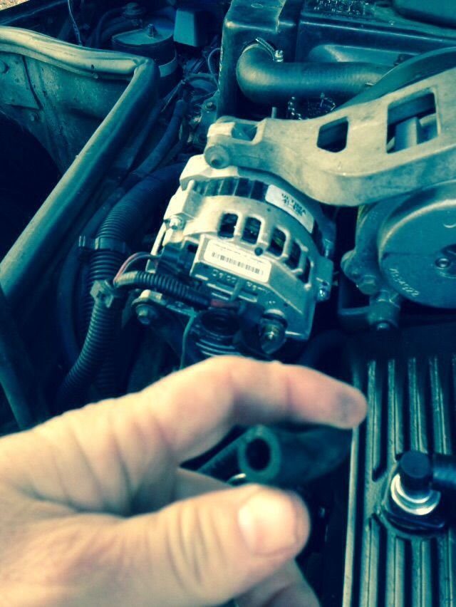

Just went back and looked at the photos I took before I started and low and behold I found the connection for the hose. It goes onto the pipe that PVC also connects to. Could this be my issue?

yep. IIRC that hose goes directly to the TB port.
