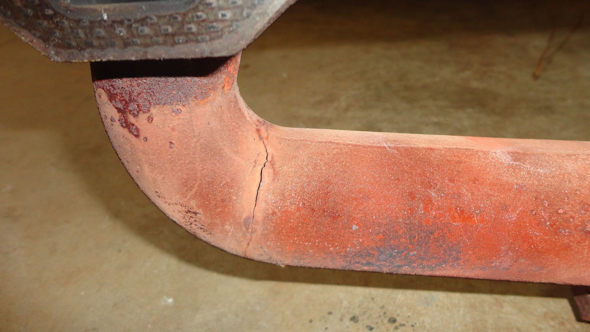

I've seen a lot of LT1 exhaust manifolds crack under the center runners, when they heat up the crack opens and you get a small leak it sounds allot like an old belt driven smog pump. You have to remove the heat shields to see it.
I let my dad listen to the sound today. He also mentioned a leak from the manifold. What do you mean by "center runners"?

The ones I have seen that cracked were the two center pipes met the main pipe. I'll look around and see if I still have one and if I do I'll snap a pic.
My bad had not looked at this in many years, The end pipes cracked, this one is off my 95 LT1 replaced about 3 years ago. I have seen this on at least 4 others all in the same place.
