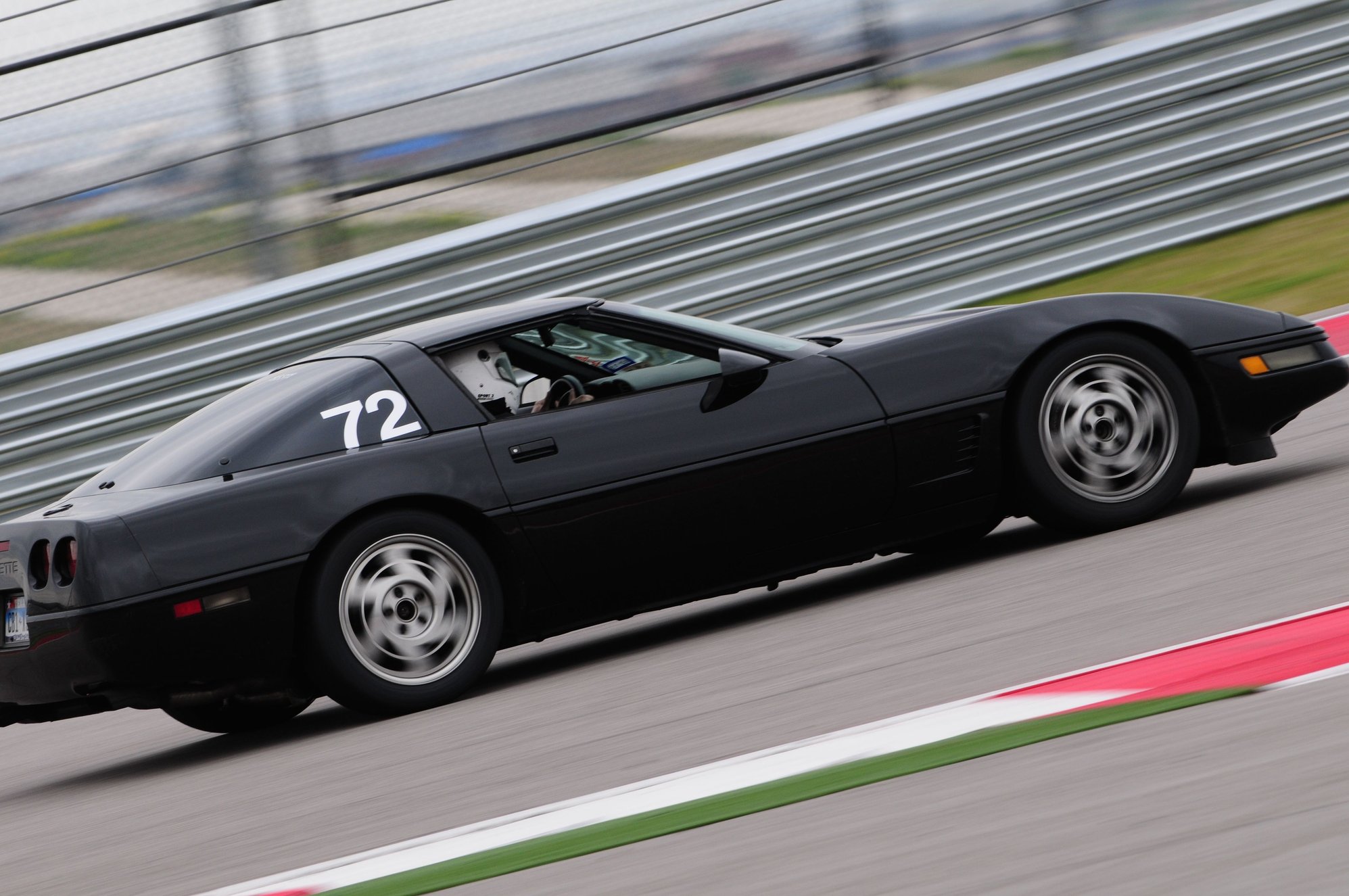

First pic is under acceleration, second I have the drivers side loaded up. Doesn't move much, but that's what I wanted. Cutting the pads alone got it low enough to just get my low profile jack under, then I adjusted the back to match.
Couldn't resist - the advantage to running these wheels in the incorrect rotation is? Maybe just conversational?

I'm more concerned with tires rotation and flipping for even tire ware than wheel direction.
There you go - it is just "conversational"!
