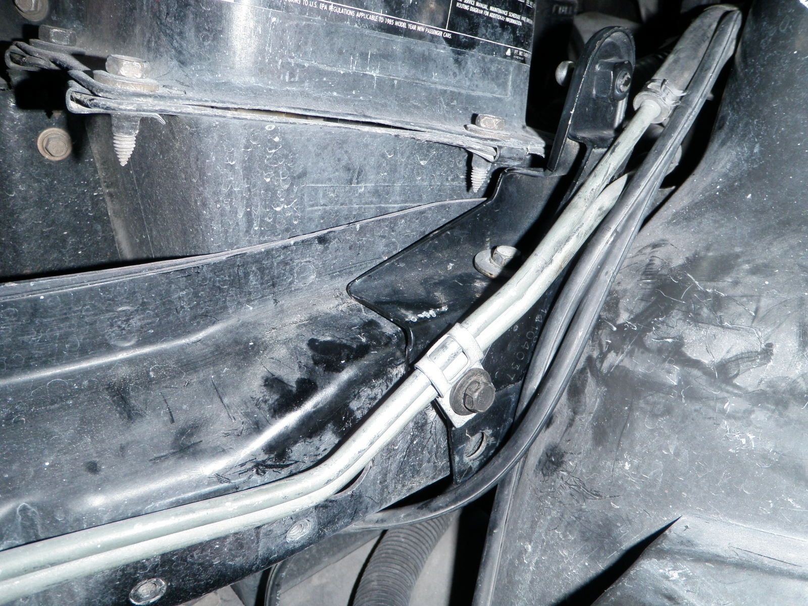

This is the 2nd time I've done this retrofit on an '85 Vette. The first time I removed the factory LH fender to frame bracket to fit the stock lower hood prop bracket. It works fine without the fender to frame bracket. This time I modified the fender bracket to fit. This is the completed install without the hood prop attached to the ball stud.

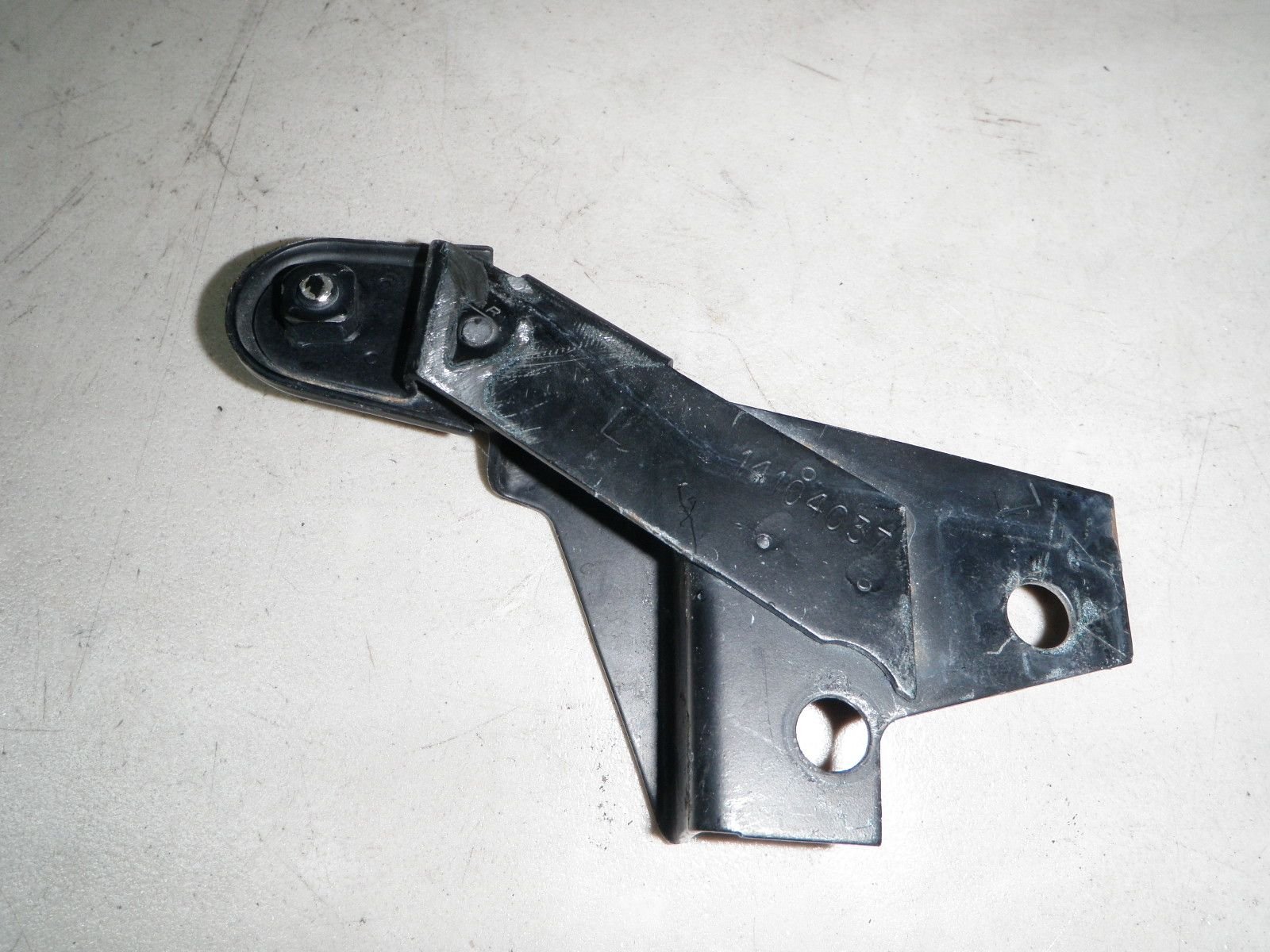

This is the factory lower prop bracket I used from a '92 Vette. I cut off a threaded stud that wasn't needed and was in the way. You can see the shiny area where I ground it off. I think the aftermarket bracket is different and modification to the fender to frame bracket isn't needed. I can't verify that.

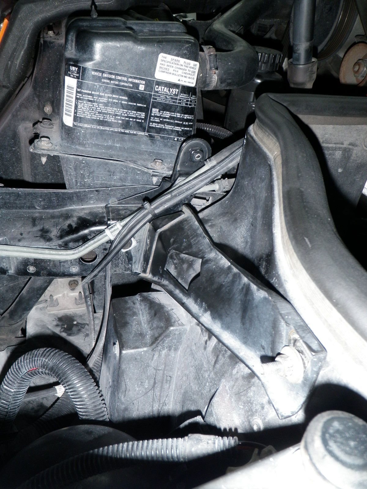

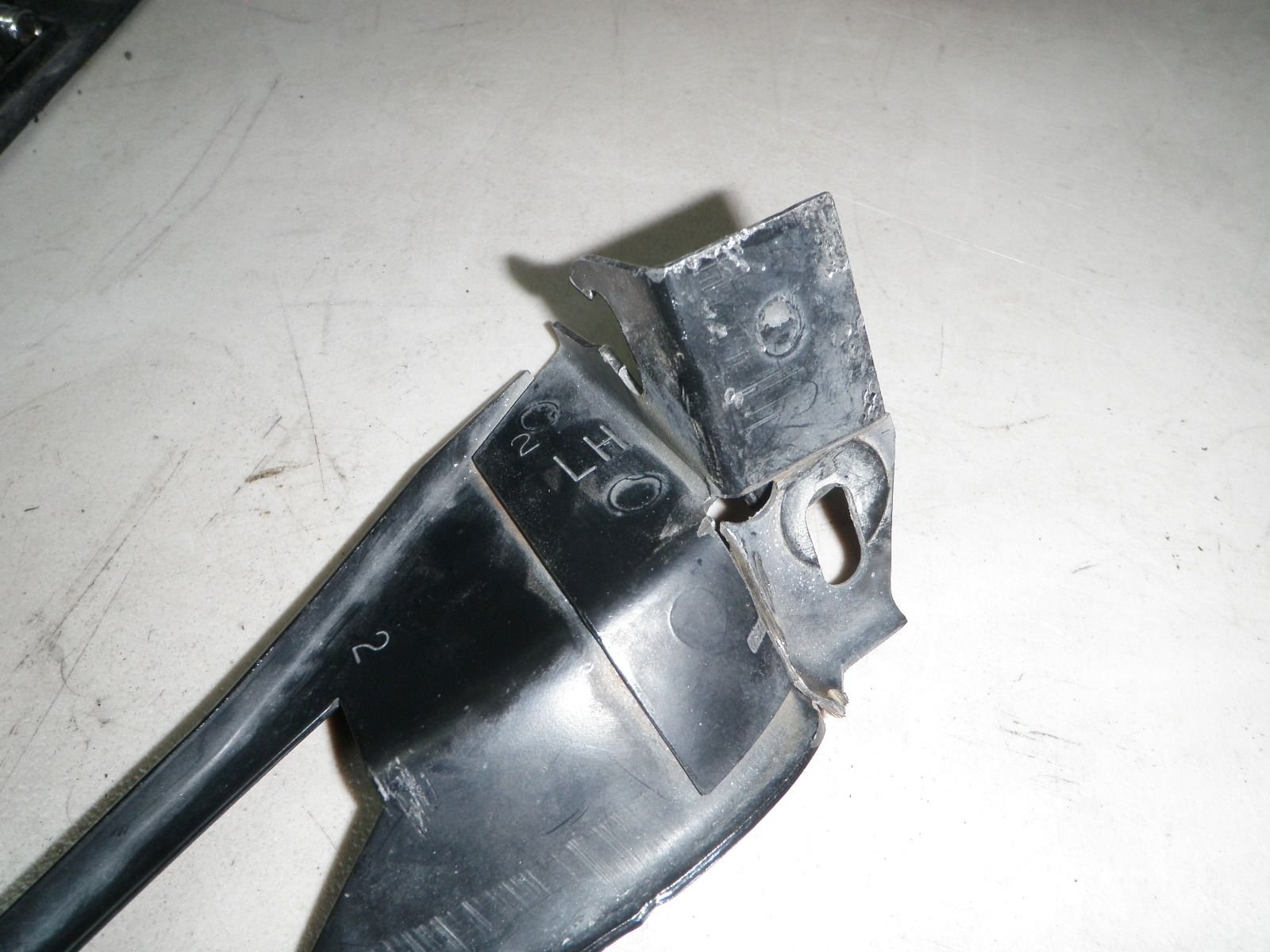

I modified the stock '85 fender to frame bracket by notching out the upper mounting hole so it would fit along with the stock lower prop bracket. I also notched out the side mounting hole so the bolt would fit since the brackets were stacked. This pic is before.

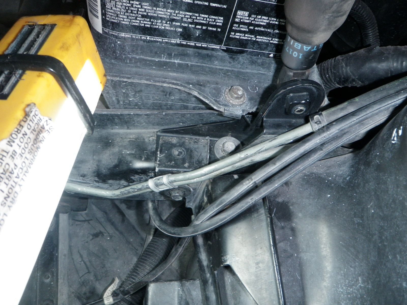

And after notching.
First the stock lower prop bracket is installed using the top bolt. The other side bolt is installed if you didn't want to use the fender to frame bracket that was notched in the previous pic. This would be the completed install without the fender to frame bracket. The lower hole on the prop bracket can't be used since there is no hole to thread into the rail.
Here's a view of the stock prop bracket and the modified fender to frame bracket. If I didn't notch the fender to frame bracket it wouldn't fit on top of the stock lower prop bracket. The one side bolt holds the steel line clip and the fender to frame bracket to the frame rail. That's all it needs.
