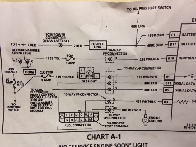

Well, finally figured it out. The issue at least and now I need some serious help with a repair.
I removed the complete SIR System. I did not have any indication that the SIR was tied into the ECM. Well it is. Section 6e3-a-14 under drive ability and emissions (Chart A-1). No service engine light, which I do not have illuminating says under test description; The SIR system Diagnostic Energy Reserve Module must be connected to the I/P Harness or switched ignition voltage will not be supplied to the ECM and his will not allow engine to start. Dammit.
How can I bypass this and get power to the ECM?

You can try jumping B3 to B9.
I am going to connect the yellow 1139 to the radio hot wire and that should hopefully get the power to the ECM.
I don't see any connections between the DERM and the ECM. It looks like the "ECM fuse" gets power from the ignition switch (through the splice next to "C") whether the DERM is there or not. Maybe this diagram doesn't apply in this case?
I know in my car the only usage for the ECM fuse is to tell the ECM that the ignition is on.

Originally Posted by Cliff Harris
I have an '86, so no SIR in my car. I am not familiar with the SIR wiring.
Somehow I overlooked the splice.
PS
The fuse block diagram shows that the ECM fuse gets power from the SIR module.

Ok, we're back. I sliced the yellow 1139 from the DERM with the Pink/Blk 439 that runs to the air bag fuse.
Here is CHart A-1 that I used from the 91 FSM.
Hopefully this will help someone else out in the future. Thanks for all replies. It helped lead me in the right direction.
