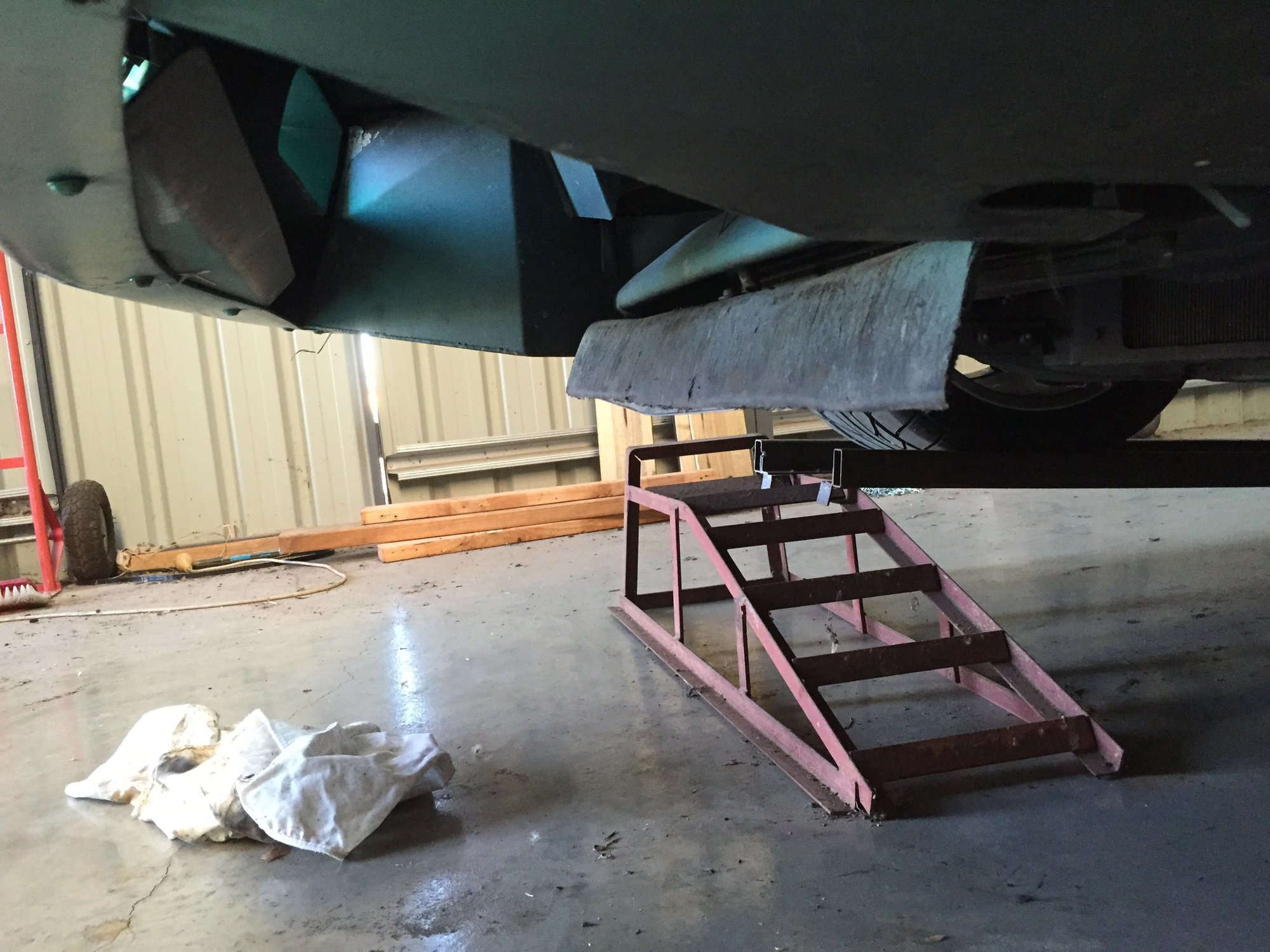

Here is a pic of what I have:
The car will also overheat VERY easily, particularly at high speed with A/C on, even when the ambient temperature isn't too high.

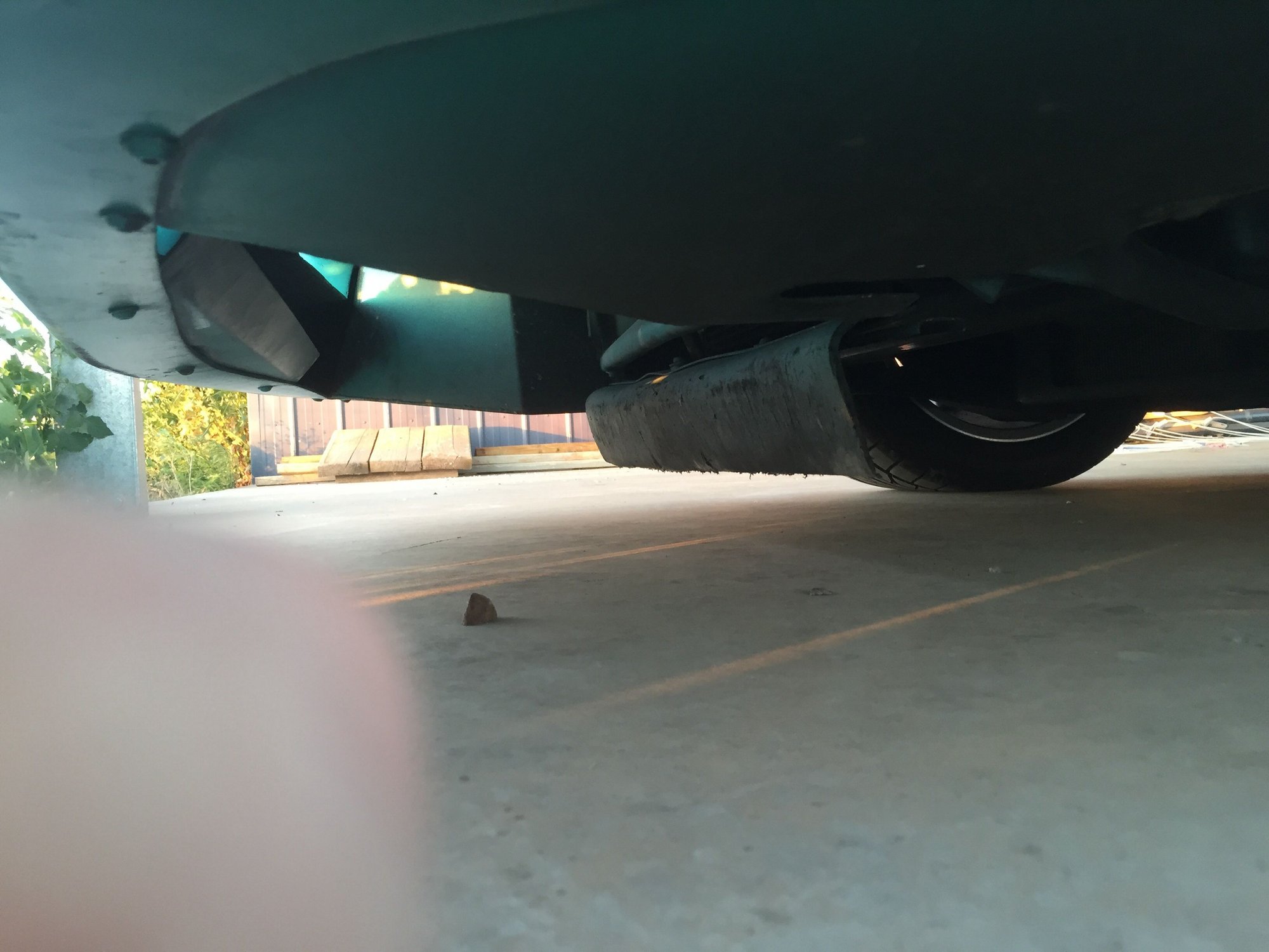

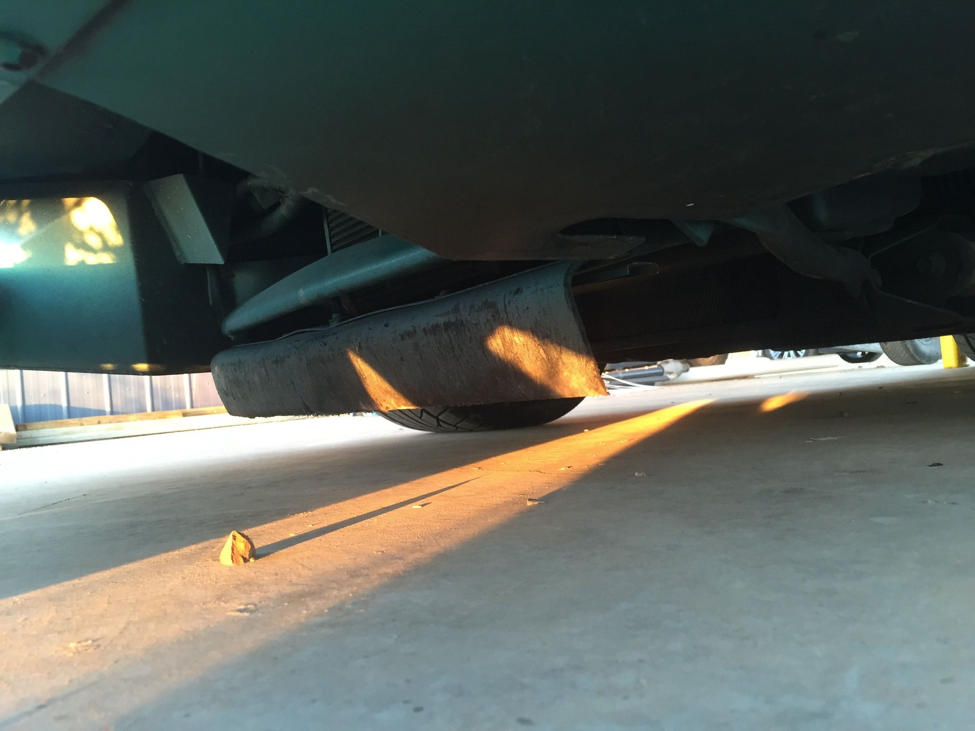

I had a look under the front Aerobody nose and there seems to be a piece designed to deflect air up into the radiator.
This piece looks like it's been scraped on something (probably speed bump) and has "folded back" and now doesn't deflect any air as it was probably intended to do.
Can anyone confirm this is a part of the aerobody kit and have a pic of an undamaged one looks like?
I think this should be at about 45 degrees not rolled over?
Obviously been hit due to low ground clearance

Check the belt tensioner. It may be worn out and needs replacing. Your air dam looks fine. Does the Calloway have side air dams? My 87 does, but it's a standard model.

GM put out a retrofit kit to prevent the center air dam from being bent back like yours is. There was a brace added in the center. It should look like this:

Thanks for the reply, mine has that piece.... The spoiler obviously has had a hard
life.
That brace was loose, but tightened now

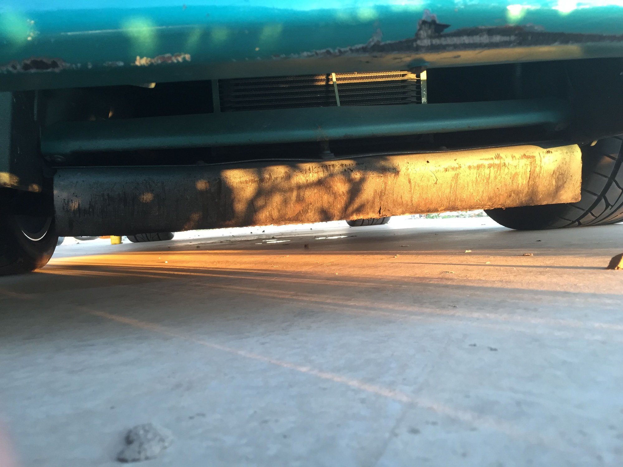

Here's what it looks like now:
You can see the aluminium plate supporting the spoiler
