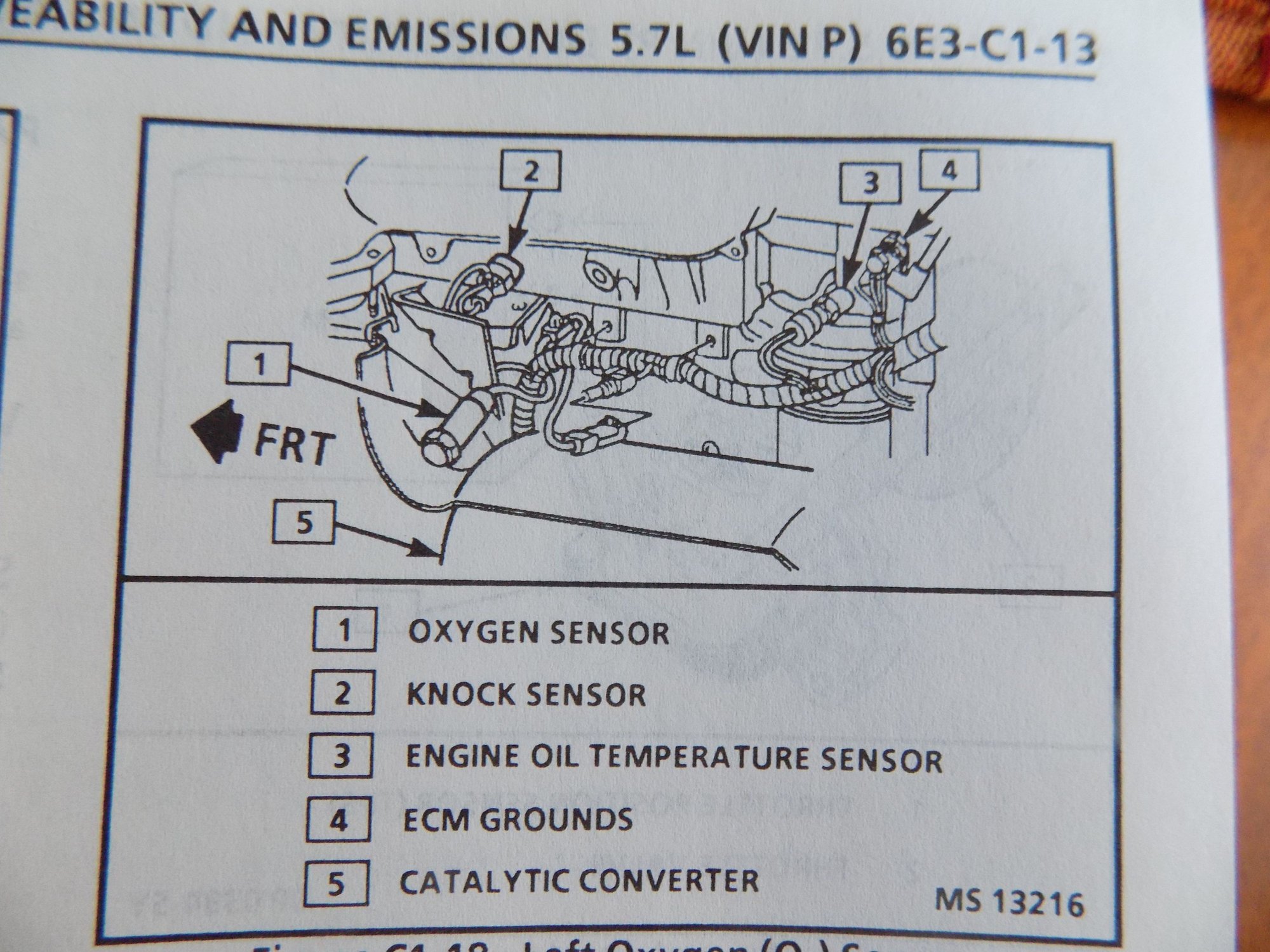

Check the ECM ground. You will have to get under the car (always fun) it on the left side (driver).....DISCONNECT THE NEGATIVE BATTERY CABLE FIRST!!!!!!

The engine sensor grounds were moved in the late '80s to a stud on the top of the bell housing on the driver's side. I know for sure that it was that way in 1989, but it could have happened earlier.
