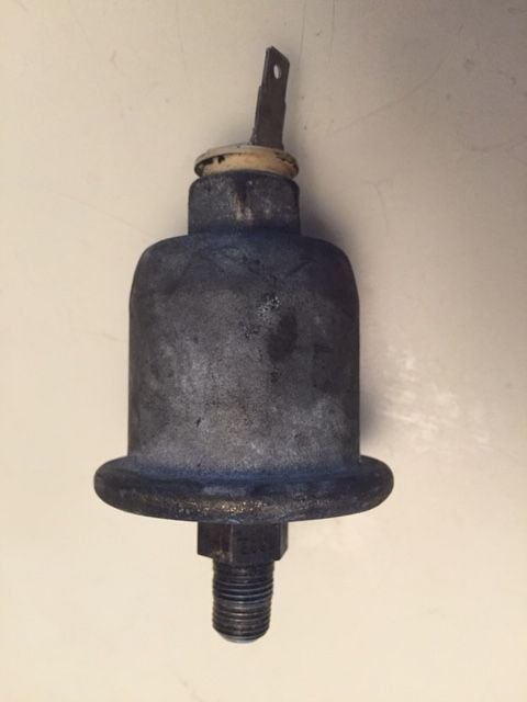

I took lots of pictures and labeled almost everything, but for the life of me I cannot figure out what this is or where it goes.
I have the manual and I have also purchased the "AllData" diy and I cannot find this thing.
After we figure this out, we will be taking a shot at the other thing I did not label as good as I should. The vacuum system. I have a diagram for that one.
I think I may have swapped the thing that goes on the EGR with this thing that belongs on the back of the engine where the 2 pronged oil pressure sensor is.

Oil pressure sender

Thanks. I got thrown off because when I searched for Oil Pressure sensor I found this. And it has 2 connectors..
http://www.ecklerscorvette.com/corve...1985-1987.html
So why do I have two of them on the back of the block. This one has one wire and the other one has 2 wires.

Ok, with your clue, and a quick search I found out.
Single wire is the pressure transducer. Two wire is the switch.
