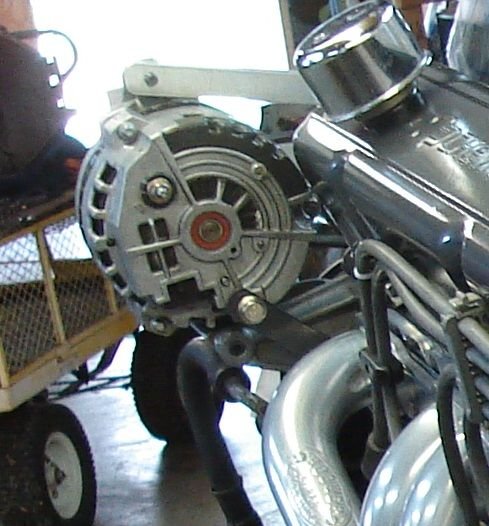

As you can see in the photo, I just extended the original bracket so it would fit on the 3rd bolt back instead of the first bolt..My Hooker headers came with small extention tubes that you can use with your original bolts so you can hook a bracket to it. You can either use a piece of conduit pipe like mentioned above, or like I did using the original bracket , cutting it in half , and welding a rod in between to get the proper length...WW
