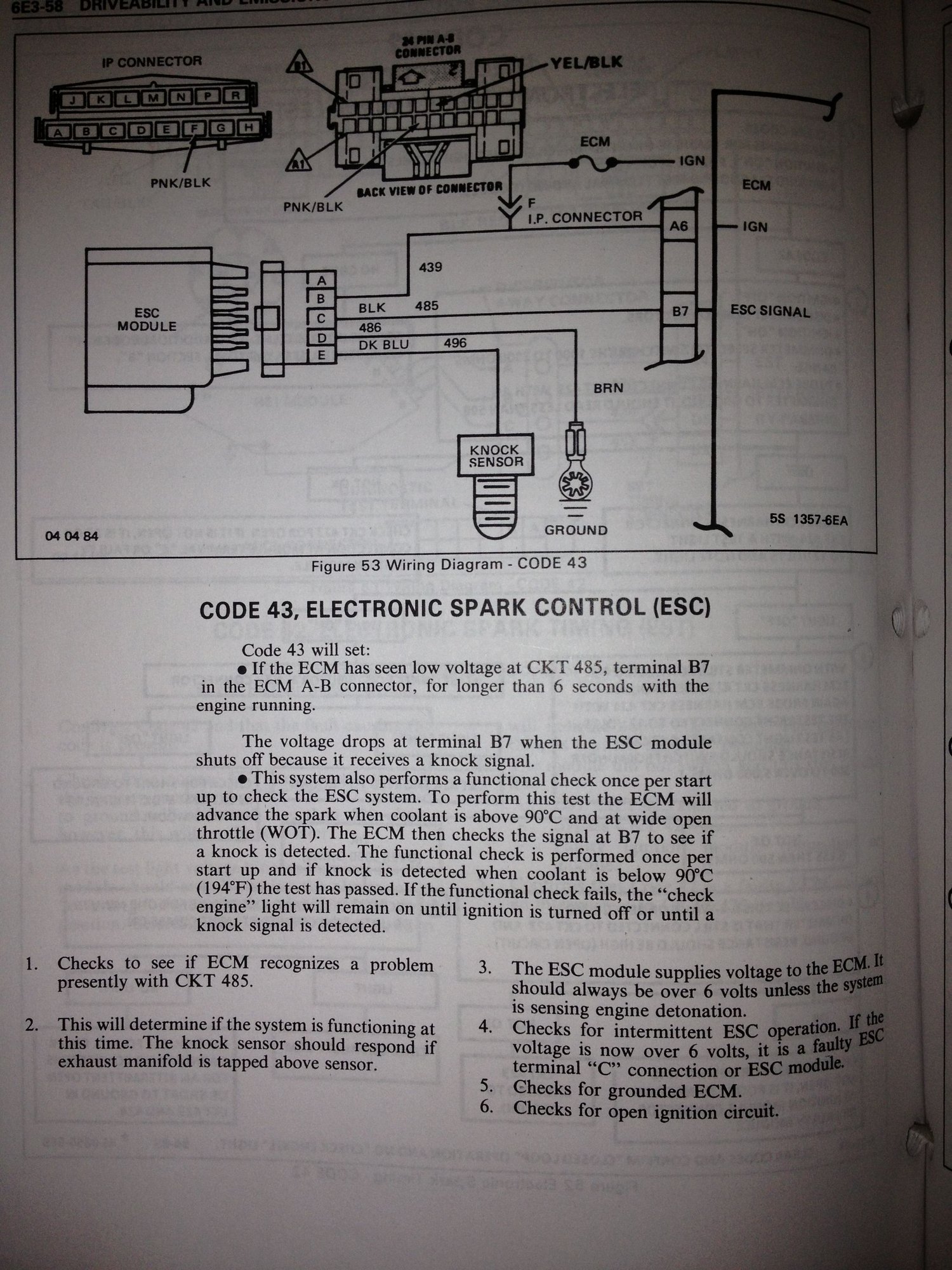

this is from my 85 FSM, you need your 90 FSM
