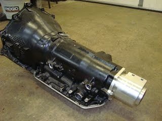

I ran across a site that seems to have an adapter to install a 4L80E into a C4.
https://sites.google.com/site/peteszr1garage/
http://www.digitalcorvettes.com/foru.../topics/143767
I called Transmission Center today and they said the C4 Adapter Kit is no longer available same as is advertised at PATC. He said it would take about 200 orders for them to make a production run. Can we mount this nationwide? So... if anyone wants to put one of these trans into their C4 they will have to make their own mods. Sorry!?
Since it is clear that the 4L60E cannot be modified for 5/6-Speed, I may do it in a couple years down the road. It seems it can be done without extensive mods. As I have read, no mods are needed to the tunnel. Mechanical mods: replace spline on front of driveshaft, shorten driveshaft, and shorten & modify C-beam. Did I miss something mechanically?
I plan to be up around 400hp and torque in about 2+ years and will need more trans than the 4L60E, and besides, 6-Speeds is just way too cool!
Try this place.
http://www.shiftworks.com/tailhousing-corvette.htm
I just ordered one from this guy... With his adapter you can use the stock manual c-beam og the stock manual driveshaft. He still had one available when I asked, don't know if he has more...
petezr1@gmail.com
