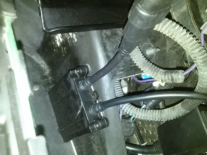

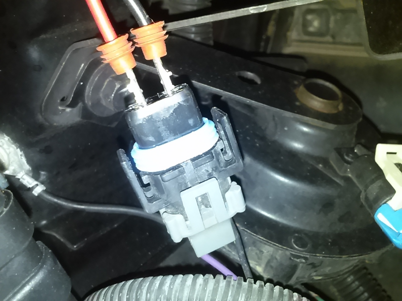

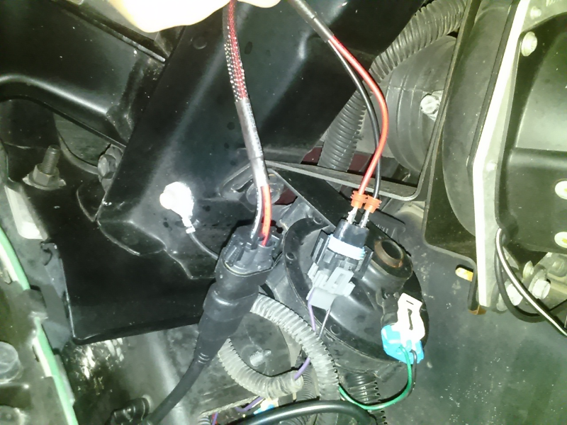

Sorry!! Forgot about this! I agree, they make me want to become a vendor for the C4 owners. I'll post them up. I posted this in a different thread. Just copy and pasted it. Let me know if you need additional help
For the HID fogs.
If I were you, I'd set the ballast first and connect the harness to it. Next, there are these two pins. You connect the pins to the factory fog wiring. Match the black with black(see wires from ballast and factory wiring). Get the bulb, connect it to the ballast, and gently slide it down the area where the turn signal bulb is. Slide the bulb down there as much as you can. Get under the car(no need to jack it up), open the fog light door. Look for bulb and where it goes in. Twist it in place, and you should be good. I know my instructions suck, but I hope it helps.

Got my HID fogs installed. Great pics and instructions. Thank you.
