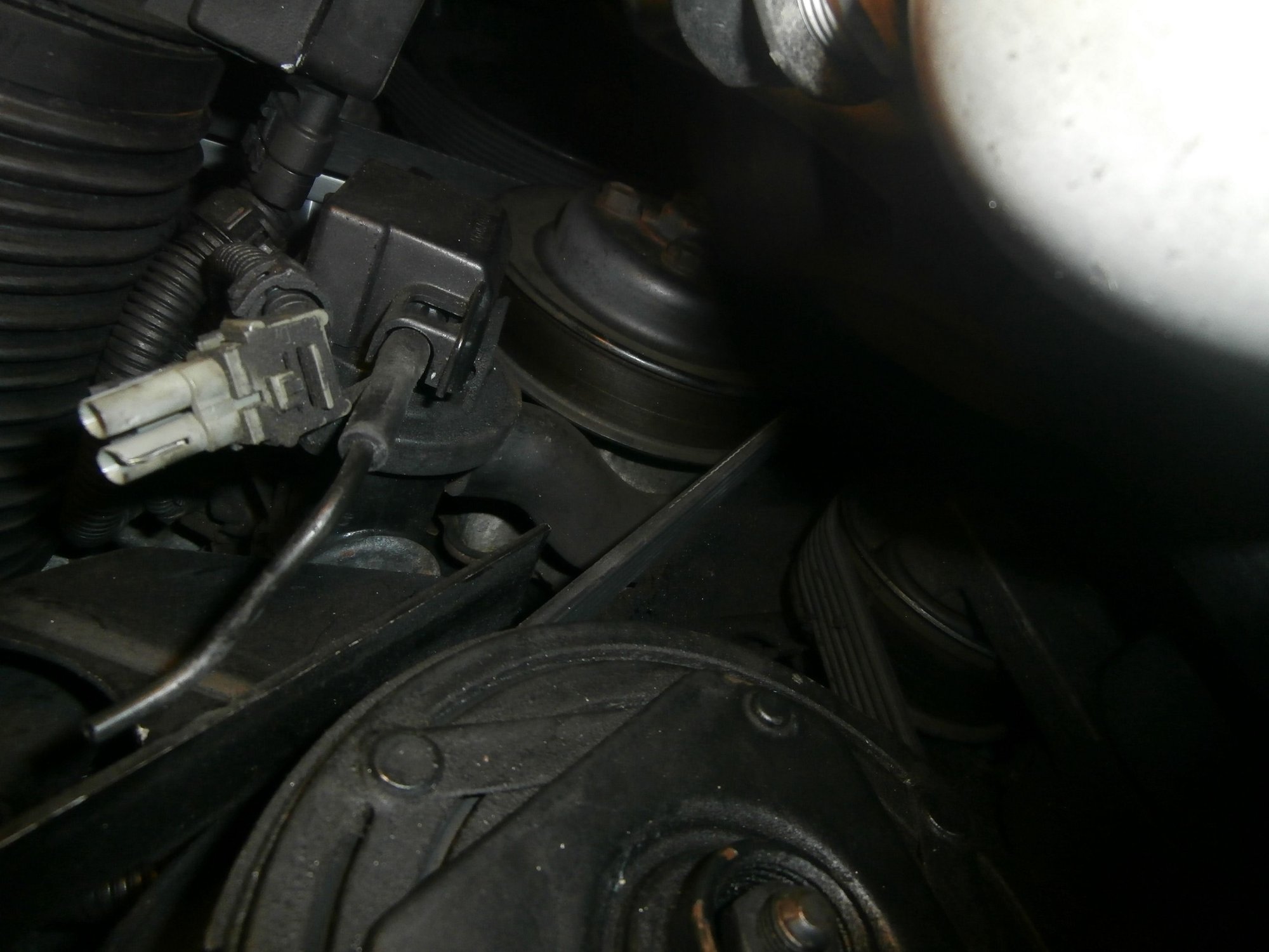

Here are the photos from the Air pump and plumbing removal. Next Installation of TPIS Headers.
