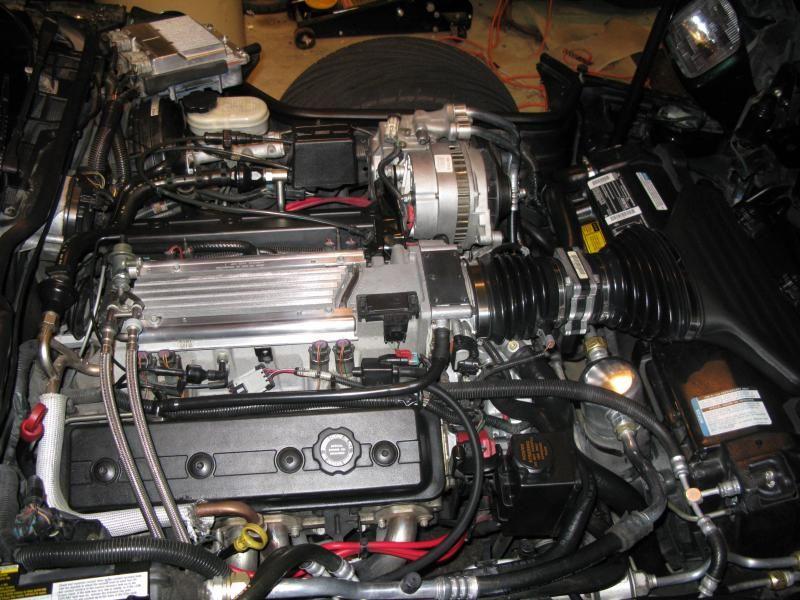

Old Mar 6, 2015 | 10:58 AM
Mr. Peabody's Avatar
Mr. Peabody
Posts: 7,706
Likes: 485
From: Everett WA
C4 of Year Finalist (appearance mods) 2019
I have a 95 auto which is basically the same engine and drive train setup as you have.
The very first thing that you want to do is determine if your rear end ratio is 2.73 or 3.07. The cost difference was only $50.00 at time of order. The 2.73 was for mileage but just changing over to a 3.07 will give you a huge SOTP difference.
I had the LT4 hat cam kit installed in mine at 70,000 miles ... that was 60,000 miles ago and I love it along with SW long tube headers.
What was mentioned above about the cats is correct. With long tube headers you have to use bullet cats which are much smaller however.........as your car is a 96 you have the OBTII software and they don't stick the probes up the exhaust pipes so you should not have a problem passing emissions inspection.
I also had a Yank 3200 TC installed and that really made a huge difference.
With the cam and the TC the car is a blast to drive.
Just installing headers does not require a retune however if you install the LT4 hot cam kit you absolutely will need a retune.
All of the above added approx. 40 rwhp on the same mustang dyno.
Your car is not going to benefit from a new (cat back) exhaust system the stock dual exhaust is pretty free flowing up to about the volume you need for 400 hp. Use the money instead for long tube headers.
Best of luck
IMG 1352
