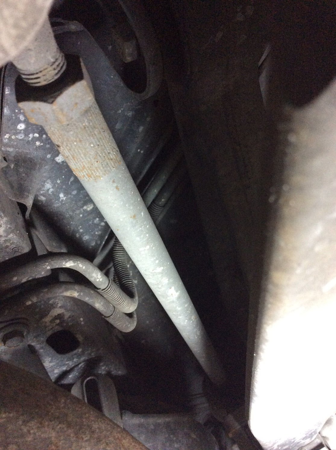

Running new steel fuel lines on my 88 coupe. Been awile since the others were removed...Its obvious how they are ran on the passenger side, but from there over the axle to the tank im not sure....Anyone have good pics, or a diagram that shows how they were ran??? Thanks everyone!

Runs down the left side you can see it follows a channel hard to tell fwd of wheels without jacking

THANK YOU for the pics, extremely helpful! Exactly what i needed!
