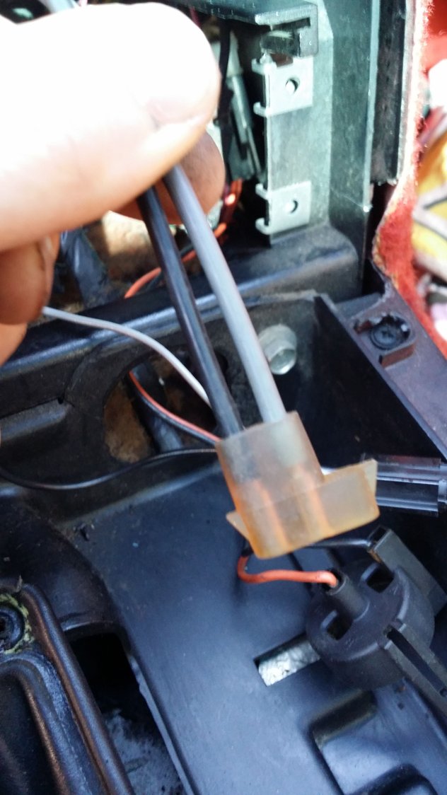

While I was fixing the power supply on my vett I saw my vacume lines for the vents were chewed up. I'm working on fixing them now and I have 2 black hoses that are chewed and only one black hose 2 conect them 2. I'm a little lost I'll post some pics for a better idea

In the second picture the black line is the vacuum source from the engine. The gray line is the heater water valve. That little vacuum connector is for the to/from vacuum lines in the engine compartment.

In the photo the vacuum lines are coming out of the center cluster through the opening where the HVAC controller was removed.
