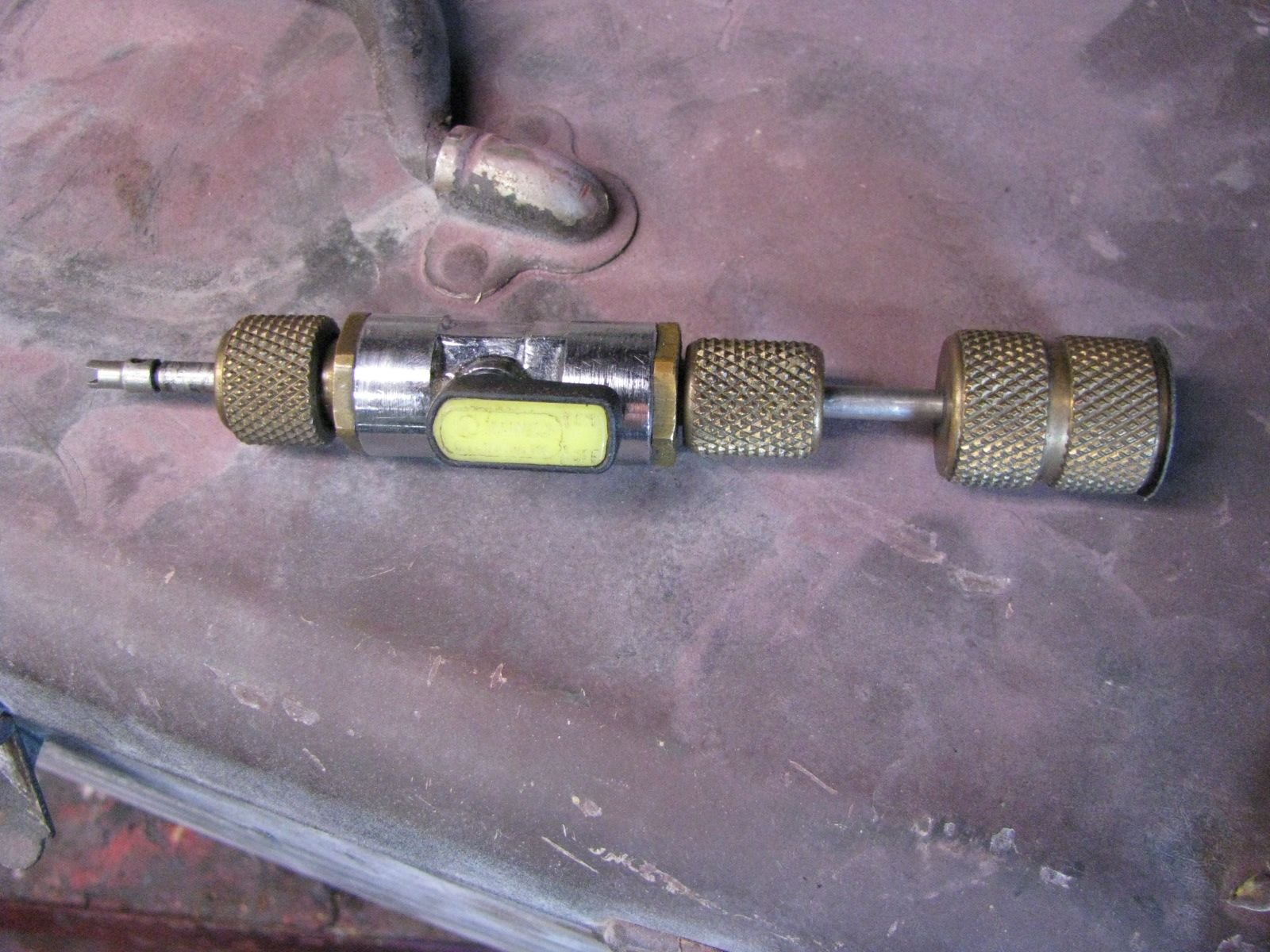

Originally Posted by antfarmer2
Yes just a gusse but the fill scharder valve is old and needs to be replaced and can be done without losing your charge
Thats dangerous advice there.
Say the system is fully charged and someone removes the schrader valve, they're going to get a face full of refrigerant and oil.
Yes, it can be done with a tool designed to do it, like shown below. I dug that out of my tools that I never use box because when a schrader valve does leak it's either already out of refrigerant or the proper cap can be put on to seal it shut.
But money would be better spent on some means of checking pressure. Say like a gauge or something....
