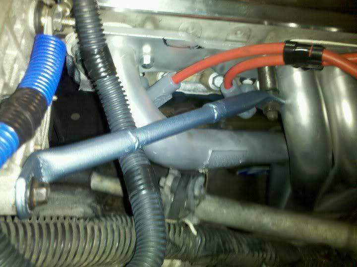

Here's a pic of a brace for the alternator. Not my engine but you can get a good idea of how it works.
If you don't have access to a welder, you can use 1/2" EMT conduit. After measuring the length you need, Just flatten the ends making sure the angles are right, and drill holes at each end.
I didn't use a heated O2 sensor on my '87 headers. I welded a bung in the driver's side collector and installed the existing sensor. The collector takes longer to get hot but it works. The existing wiring was long enough.
