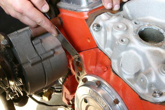

Old gasket removal is highly critical to obtaining a good, leak-free seal. Using a putty knife, lightly scrape the water pump mounting surface until the bare metal of the block is clean.
Before simply slapping a gasket down and installing the new pump, take the time and thoroughly clean the mating surface (see photo 1). If you’re unable to remove the old material with a scraper, stuff a rag in the ports and try a small diameter wire wheel attachment. Often overlooked, this is a very crucial step for a long lasting seal.

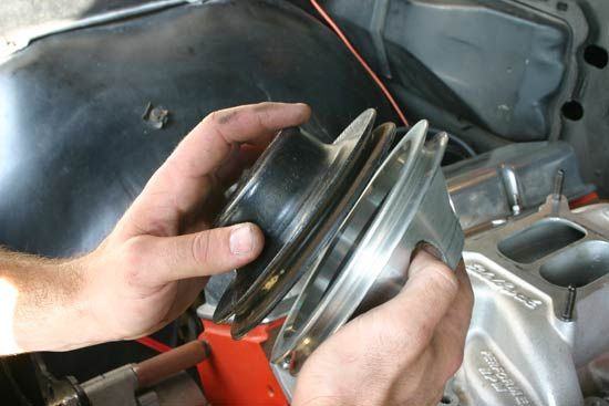

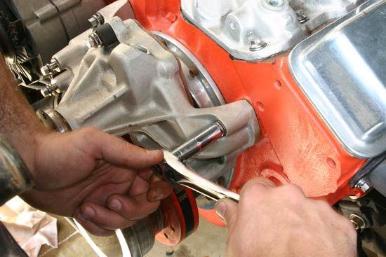

Using a small amount of gasket sealer, apply the new gaskets on the block and install the pump. Let the sealer briefly “set-up” prior to installation to avoid the gaskets from slipping out of place. As seen in photo 2, tighten the water pump mounting bolts slowly and evenly. Remember, aluminum has a higher thermal expansion rate than cast iron so be careful not to over tighten. It’s always best to follow the manufacturer’s torque specs whenever possible. In addition to the water pump, we also decided to purchase an aftermarket aluminum deep-groove pulley. These work great for positive belt retention in high performance motors, and they save weight. Every little bit counts!
In addition to reducing engine weight, most aftermarket aluminum pulleys are deeply grooved to allow the fan belt to fully seat into position.
