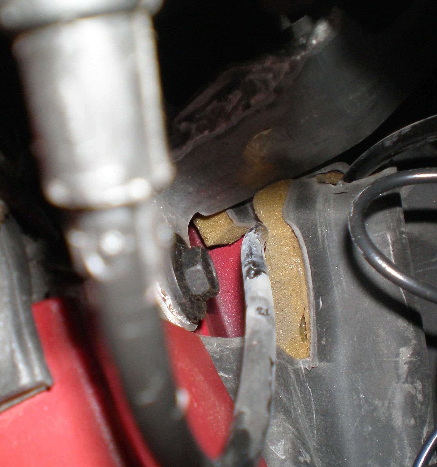

Old May 5, 2015 | 11:12 AM
fpnmf's Avatar
fpnmf
Joined: Jun 2014
Posts: 152
From: Ponce de Leon FL
Todays update...
The mechanic is not working for a week or so....family illness.. then I expect he is gonna be covered up for a bit..
Sooo I decided to take my time and get started... the early 84 must be a little different.. After I got the panel out (three screws and a clip) I could not see where the cable went thru the firewall.. So then I took out a brace/bracket to get a better look..lots of gray foam hiding the cables..
I went outside and cut the boot off and pressed the plastic retainer inside.
Put a light outside the hole and looked inside.. cant see the plastic piece..
I am done for today as the sun is out and it's getting hot and my bones are getting real sore...
Tomorrow I am going to tape a wire to the cables and pull them in from the outside.. if I can see a way to put the plastic retainer thru and push it back thru I will..otherwise I am going to cut the retainer off and put some rtv around the boot..
Craig

Old May 5, 2015 | 01:50 PM

Once it cools down some tonite I will wiggle back in and take a few pics..
The cables disappear into some gray foam.. With a light shining in from the outside I can see some light but the plastic retainer cannot be seen..I might be able to pull some of the foam out of the way but it is pretty stiff..
Good prep work for getting ready to do complete weather stripping next... and yes I got the good stuff from Willcox..
Craig

Old May 5, 2015 | 02:15 PM
fpnmf's Avatar
fpnmf
Joined: Jun 2014
Posts: 152
Originally Posted by VikingTrad3r
wonder if somebody enlarged the hole, then had to usesome spray foam to lock the grommet into place??? ill take pics of what it should look like.
It looks like the car hasnt been taken apart previously...
I removed a bracket to move the wires over...
Looking closer it is not just foam it it a plastic backed foam...
Here's a picture..the hole is behind the plastic foam wall..
One cable is obvious the other one is at the top of the pic..
