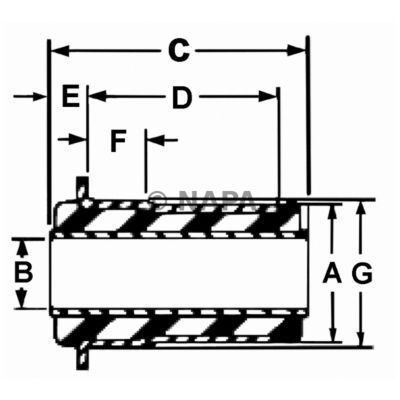

Looks pretty close, eh?
Dimension A O.D. : 2.18"
Dimension B I.D. : .58"
Dimension C Length : 2.6"
Dimension D Length : 2.02"
Dimension E Length : .35"
Dimension F Length : .35"
Dimension G O.D. : 2.2"

Okay. I ordered the 88912761 from the Dealership since AC Delco shows these as the Alternate/OEM number for the 45G11014.
Priced nicely with a discount and no shipping charge. Amazon has them also. I have the Energy coming also. So I am covered.
I am trying to get the bushing out without ruining it to compare. It's a bit of a challenge. I have to go Monday and see if they have the GM tool. I remember seeing something similar way back when.
Thanks
EDIT: Here's the proper GM numbers for a C4 D44. Old #14046958, newest #14066929,. Discontinued in 2005. No dealership in the U.S. has them.

I don't believe but let me do some numbers. Do you have the entire NAPA dimensioned buyers guide or do you need to sort it one by one? I believe I have a Moog buyers guide somewhere. I'll look. The one nuisance I see with the one you've mentioned is the double stepped OD, the ID and the length of the outer sleeve.
How rushed are you? I wanted to do something Monday with this but it could be as late as Tuesday. I've got the NOS D44 cover and I can measure more closely. It was something around 4 AM when I did that and I was certainly not wide awake.
That double step has me wondering also. I have one of the bushings removed, but I demolished it.
I don't have the NAPA guide. I went by the info on the website. I think it is a NAPA branded Perfect Circle product. The Moog number should be K6116.
I will have the rubber GM bushings 88912761 Tuesday.
