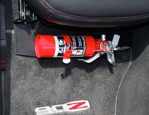

We manufacture a mount for the C6 that mounts to the front of the seat rails on either the driver or passenger side of the car. We make them in the USA out of aircraft grade aluminum. We are a small Mom and Pop company and are happy to help if you have any questions.
Here is a direct link to the C6 bracket and some photos.
http://speedtactics.com/vette_0512_feb.php
Speedtactics Corvette C6 fire extinguisher bracket and 1.5lb Halgaurd fire extinguisher
