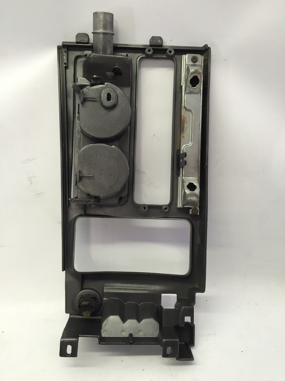

here's a pic of the underside of the console. the (silver finished) bulb bracket is held in by two (2) torx head self tapping screws. that bulb bracket holds captive the shifter lens, and the lens blackout plate. the shifter needle slides within the lens and the bracket.
you may be able to lift the console bezel enough to access the screws, but remember, you'll still need to get the proper tool in there to secure the assembly. it may just be easier to remove the console bezel assembly.
Hey Joe - that is incredibly helpful (together with the info you sent in your PM yesterday).
I'll have to see if I can wangle a stubby in there to replace the screws. Thanks again!
