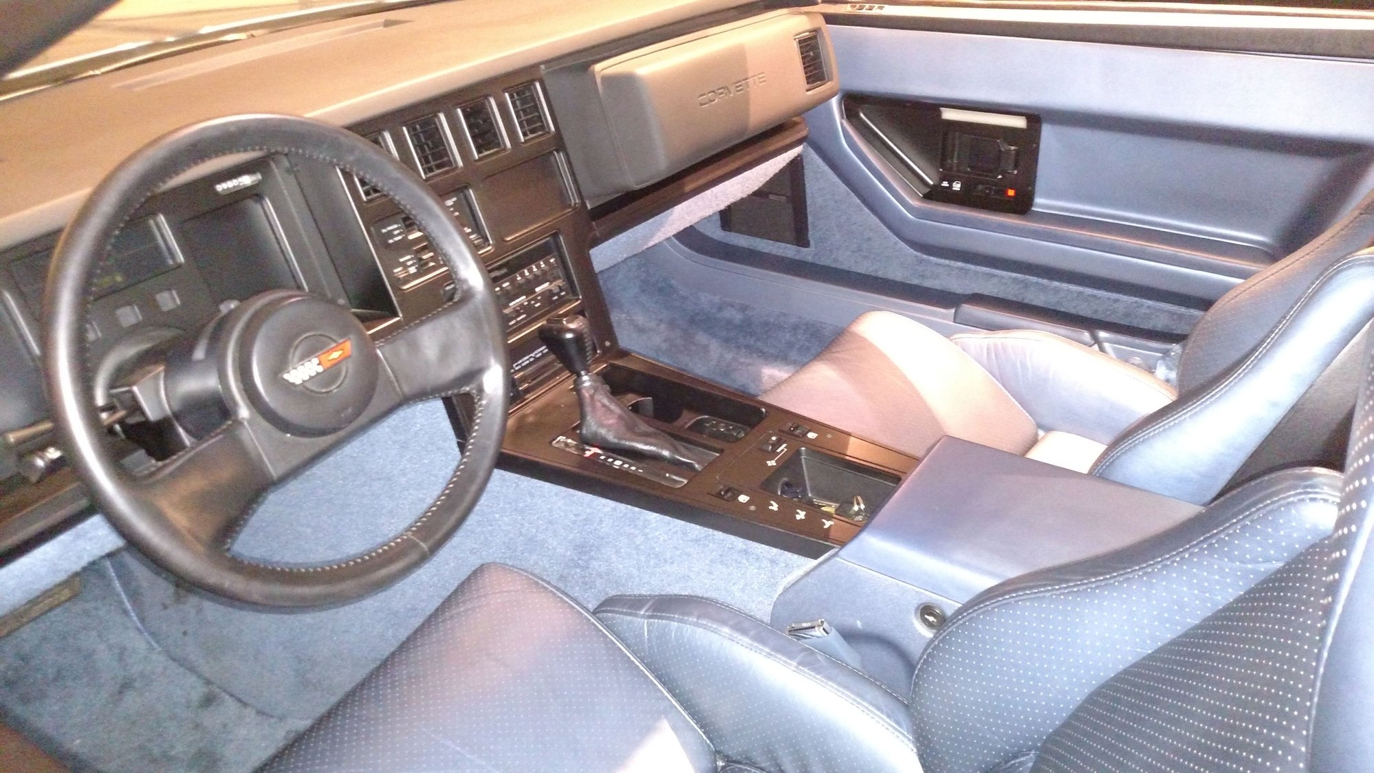

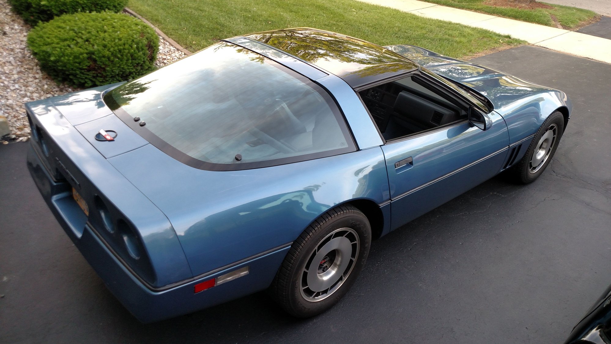

Old Jun 5, 2015 | 09:12 PM
HUDDA's Avatar
HUDDA
Posts: 300
From: WINDY CITY
She's home!

Old Jun 5, 2015 | 09:38 PM
dclafleur's Avatar
dclafleur
Joined: Sep 2005
Posts: 6,551
Likes: 36
From: Jenks OK
Looks about as clean as an '85 gets.
