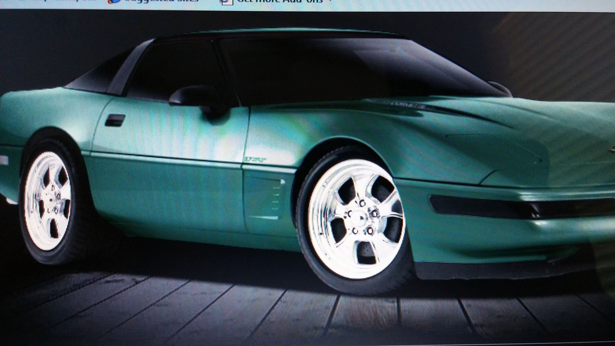

Default Trying to decide between these 2 on a PoloGreen C4

1st, 2nd doesnt look bad but everyone and their brother has them

That's what I think too. I already have a less than abundant color, I don't want my wheels like everyone else....yet every time I pose the question to people, the torque thrust are chosen more often. I've been stuck on #1 from day 1 myself

I'll vote for the second set. Torque Thrust 2's are one of the nicest rims I've seen on c4's especially LT cars. There's a reason a lot of people have them

first pic, looks better and NOT so common
